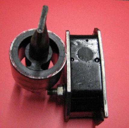

Here's a pic of our poly mounts (these ones are in my car now). The local repairer did note that there was a little bit more vibration in my car because of the rear one he thought, but to me I don't really notice it.

The front two are easy, no need to remove the engine for these. Jack up the front of the car and support the engine by the sump with a block of wood on a jack so as not to damage the sump. It takes about 10 mins each to remove them. I've never done the rear but it will need to be pressed out and back in from the look of it.
Scott. I would send you my plates and get you to make a set but I love doing this sort of thing myself. I did a bit of reseach before your reply and I came up with a similar spec for the hardness.
They look really good, nice job

Thanks Nick. Luckily there hasn't been any money sunk into it, or I'd be broke. Getting the plates laser cut is possible but it's a lot of extra hassle when there should be plenty of old mounts around anyway. I've read posts by some people using a DIY poly kit bought from a hardware store, but I doubt you could control hardness.
X-rad: Didn't want to deviate too far from the Alfa design especially with a material that was already different. If people want solid ones, it's very easy to modify the mould for 1 or 2, or 10! I think solid ones would be very harsh, but I don't know.
John, what nick said. But one more thing with the rear one: If it's really sad, you can separate the bar from the rest of the mount by using a shifter on the flattened end, just twist. What you're left with then is a short piece of pipe with a little rubber in it. It is much easier to press this out because you can use standard depth sockets and a G-clamp.
