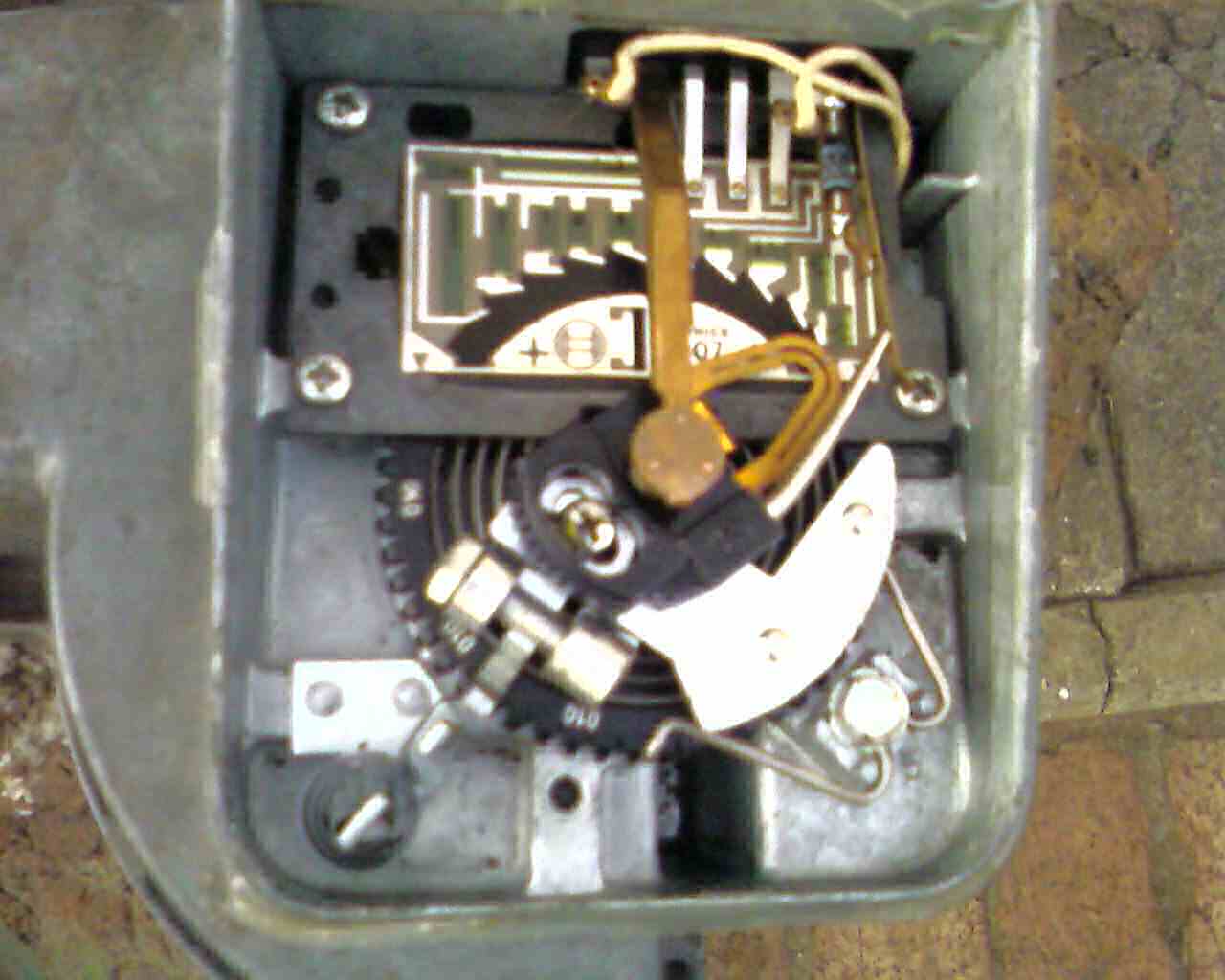

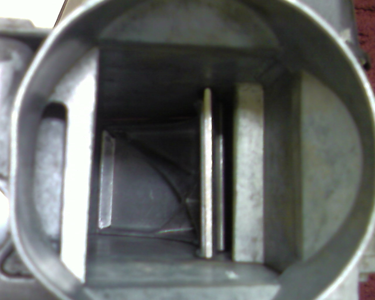

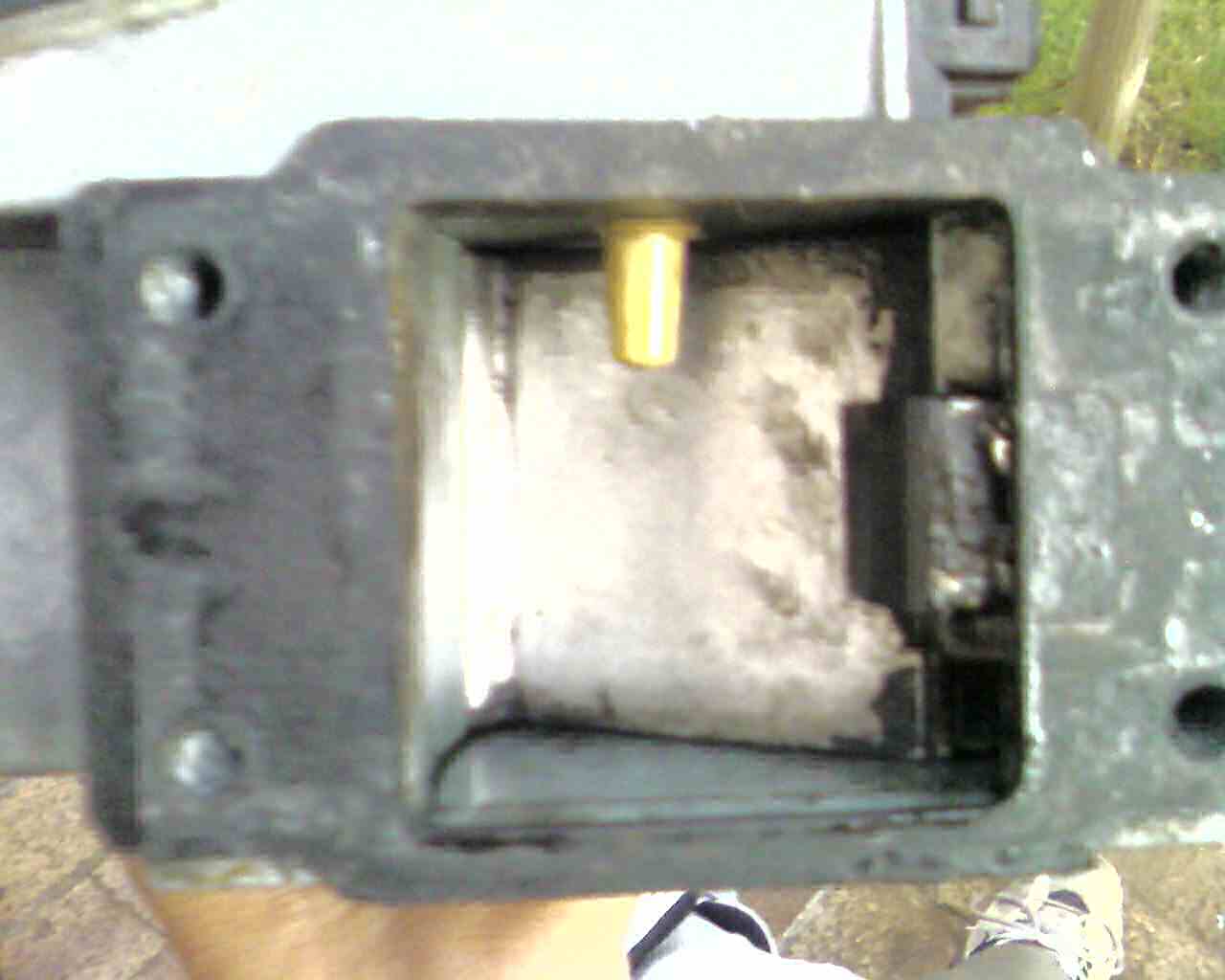

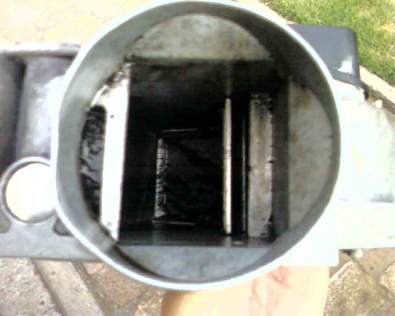

Here r some pics, if it'll help.

Your AFM spring assembly looks normal.Two things I do notice:
1) Time for some housecleaning.The inside the AFM should be sprayed with some carb cleaner.It's important that all the grunge be removed to ensure smooth movement of the "flapper".
2) May just be the photo but in the last one the edge of the "flapper" looks crooked .Have you had a backfire recently ? If it is crooked that will prevent proper full movement.

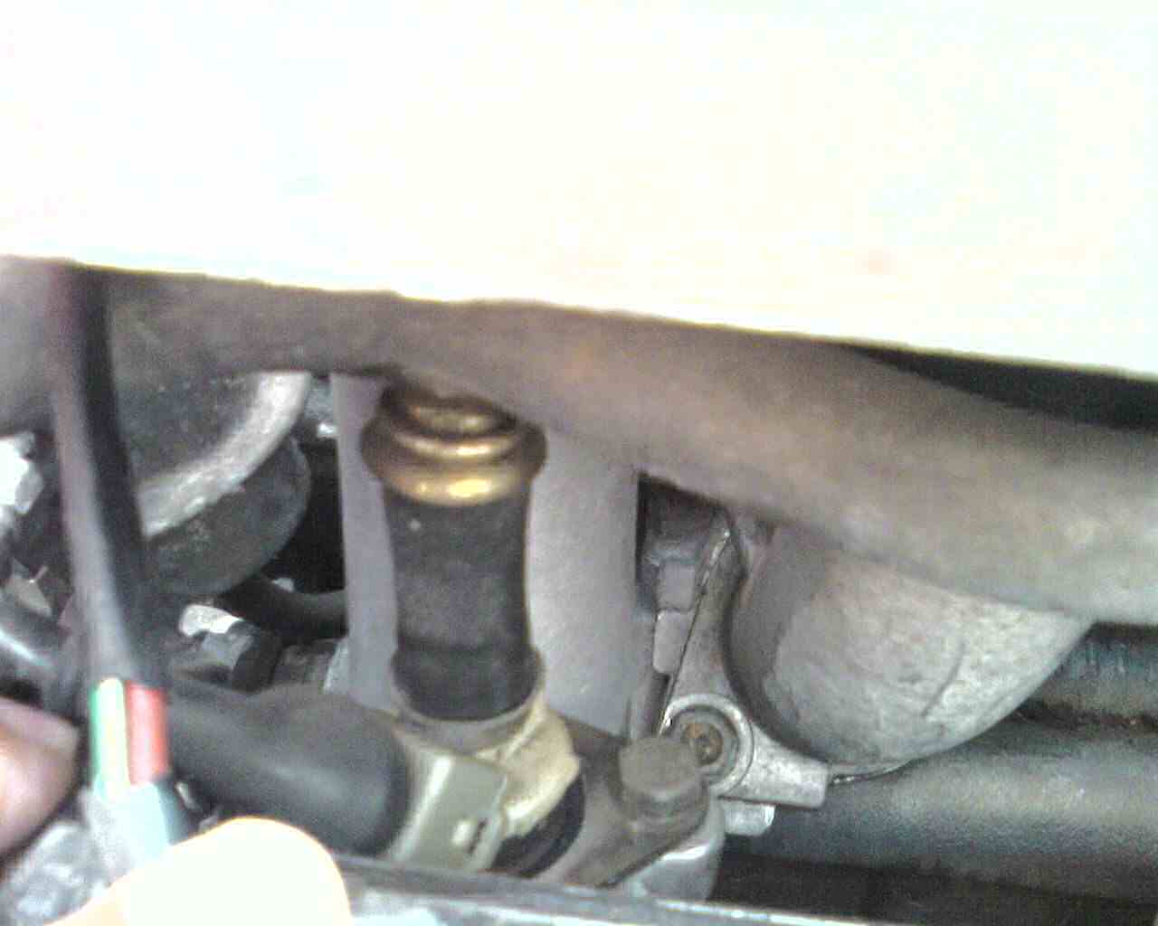

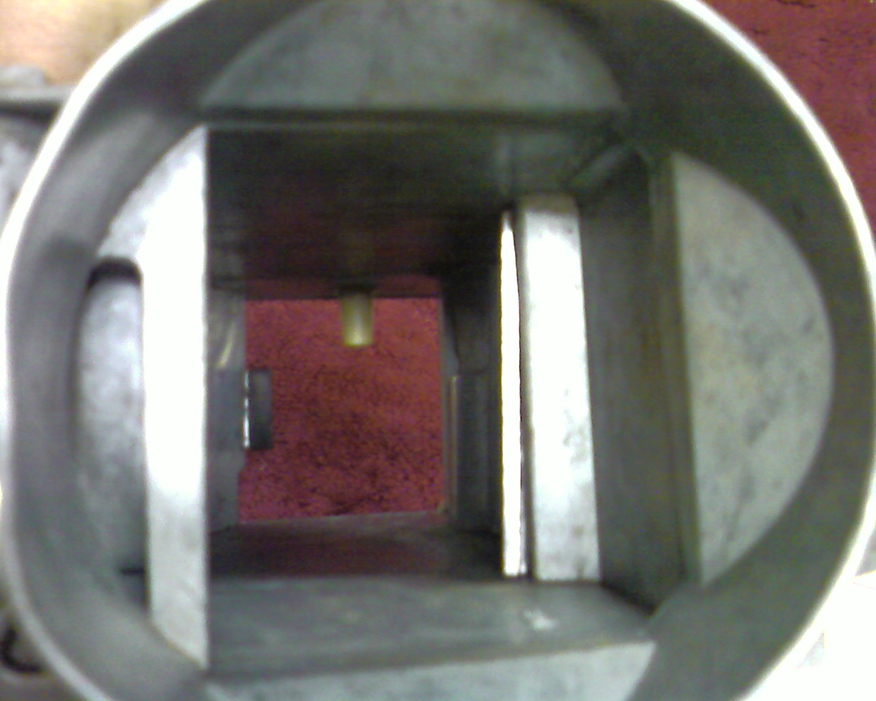

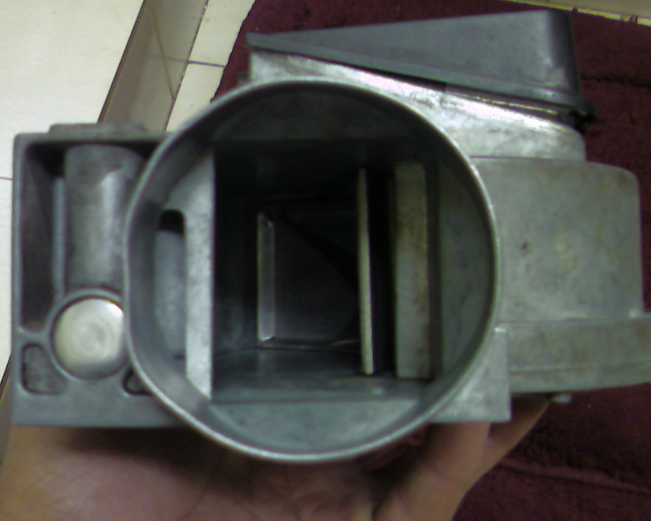

I dont need to use the pedal to start the car.Just a crank, and it starts..The backfire i got over the weekend, was while i was onening and closing the throttle with my hand, while looking if i could see something in the afm.Here's some clean pics. Ill try and find a replacement afm..

The flap has smooth movement, all the way from closed to open.
Cleaned the whole thing, all the tracks and contacts inside the afm aswell..
The flap noise seems to be almost gone now.
The car usually started first time, just by turning the key..
Only started on the fifth turn this morning, lots of smoke out the tail pipe.
I also noticed some petrol coming out the little rubber pipes that sit above the injectors.
I changd the petrol filter a while back, do you guys think that it could be a dud ?
