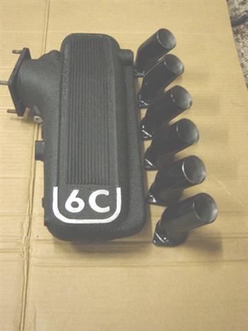

Plenum and runners are finished.

How did you paint the plennum and runners?
'84 Red GTV6 3.0
David
Posts: 160
Post by David »
Jose,
Runners have been brush painted with black POR15.
The plenum was sprayed with VHT Black Wrinkle. The can of Black Wrinkle did both cam covers and the plenum.

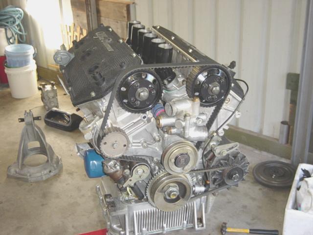

Just an update on the project so far. The engine is just about completed. Higher flow injectors are on their way and the MS components for converting the V2.2 board for spark are being ordered.
A few issues to overcome when using the 3.0L crank pulley and water pump as the pulley sizes and alignment are different than bolting on all the 2.5L stuff as I did last time.
The alternator is now driving off the pulley that the 164 power steering pump originally used. I am modifying the 2.5L AC compressor mount and then the second belt will drive the water pump and AC compressor. Will also be replacing the old Yorke compressor with a smaller rotary unit off a 75. This should just clear the oil filter.

Silicone runner joiners

Are these silicone runner joiners the one proposed by Greg Gordon
or did you make it by yourself ?
Long live to snakes on wheels !
David
Posts: 160
Post by David »
Billy.
I cut these myself. The silicone hose is used for turbo applications. It fits the 164 plenum intakes and the new inlet runners I made perfectly.
David
