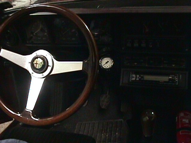

I have some a question abuot where to place my external oil pressure gauge. Have a look here and help me out with tips.

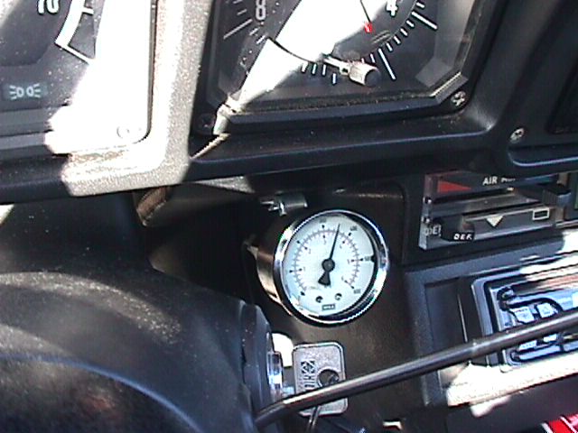

Well, here is how I did. Found a good spot between the consoll and the stearing column. Nice to see I have good oil preassure aswell. Has been a bit worried about that since the original sender unit hasn´t been working great.
Just some pics to show where I put it...
