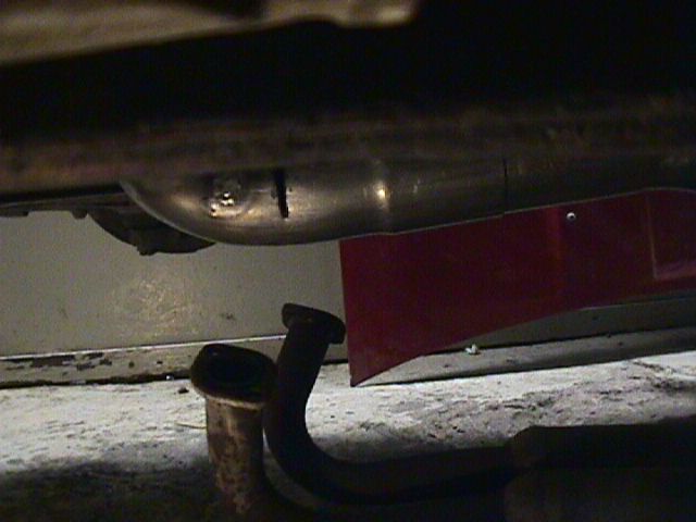

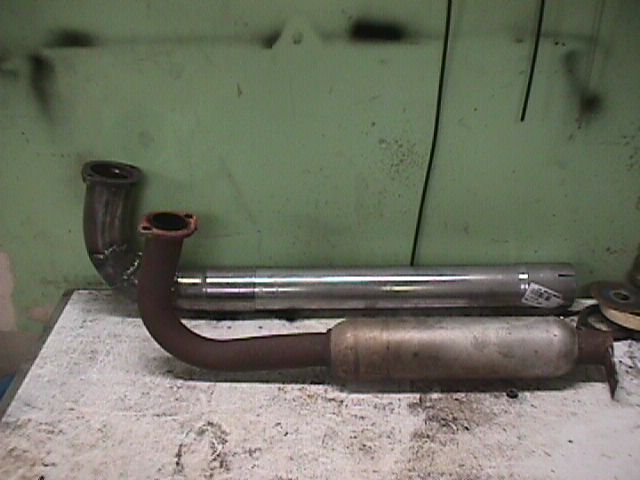

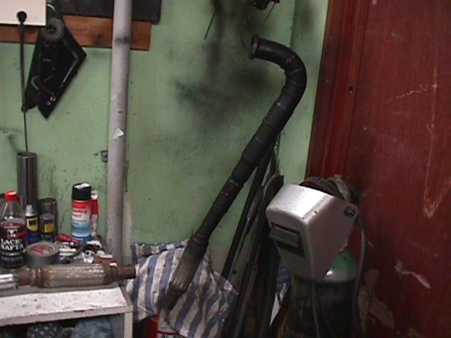

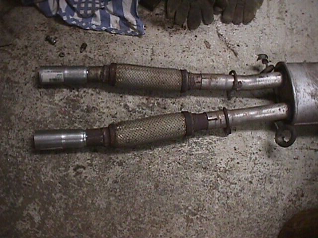

Dave, the headers are similar. I´m talking about the angle of the raw material of the pipe I built the down pipe from. You can see it in the second picture in my last post.

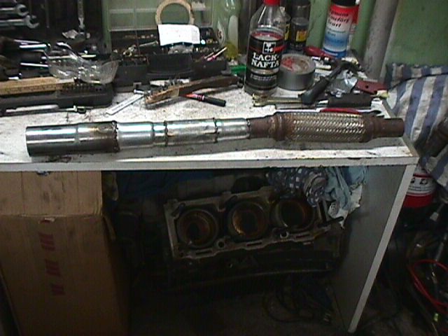

Here are some more pics of what I´ve allready done so far. I hope to get it finished up this weekend.

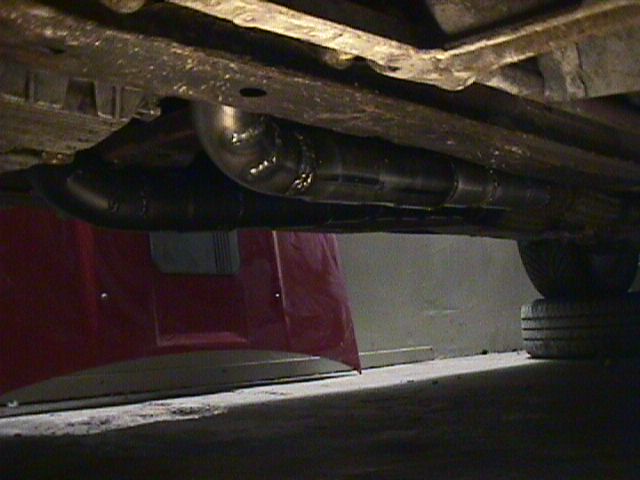

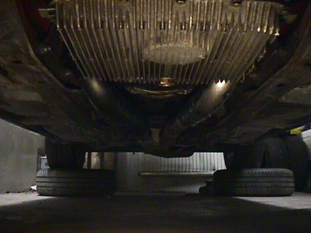

Ok then, finally got it done today. Well, that is, I´m 98% finished with the welding, so I could test mount everything. Seems to come out allright.
Some pics...

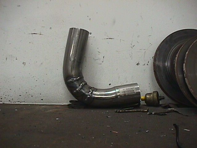

Seb,
Why so many welds?? Is it because you wanted to bend it a little but didn't have access to a pipe with proper angle and length?
Seb
Posts: 222
Location: Gotland, Sweden
Post by Seb »
Yup, a lot of welds it is!
Right, and I had to step it down from 2,5" at the bend, to 1 3/4" at the flex pipe/first muffler.
The bend I used was 90 degrees, what I needed was a bend somewhere between 70-80 degrees. So instead of making 1 cut and get a sharp bend, I made a few.
