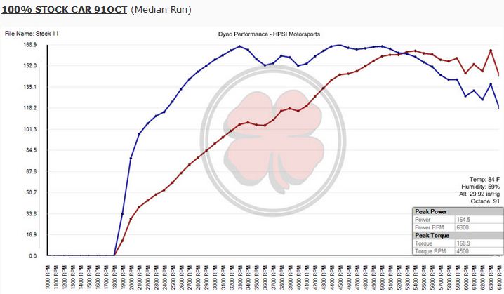

Here is a stock power run:
Stock Dyno.JPG (52.22 KiB) Viewed 6654 times
