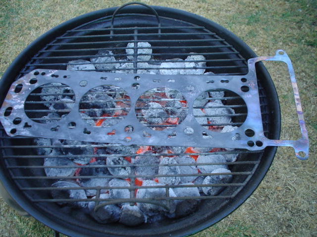

Cant get that copper gasket soft?-Barry
I battled for ages,not enough heat from 2 gas torches..
Finally got desperate..It worked a treat!.. :wink:
A bag of charcoal and a weber ...
Do you enjoy it with mustard or BBQ sauce :shock:
Yes Micke,desperate times call for desperate measures...All I can say is it worked and very well at that!.. :D :D
Copper went all black and had a flaky coating on it.After cooling,I brushed the coating off with a brush..

Ovens at Bholer steel ..Big enough to park a semi trailer in..As the guy said,a bit overkill?
Besides that I needed to this myself and see what needed doing to get the desired results..Ive never worked with copper before,always thought it a bit agricultural on an Alfa engine..I always did it the more refined,more difficult and more expensive way.This engine did not give a continental about refinement,it just spat my gaskets out..
So I have looked at copper ,but theres a twist to the tale here.Its not only copper,I had to put something exotic in the mix as well.
As soon as I have confirmed that it works,Ill post.
I reckon this is going to be the ultimate headgasket setup .. :!:
