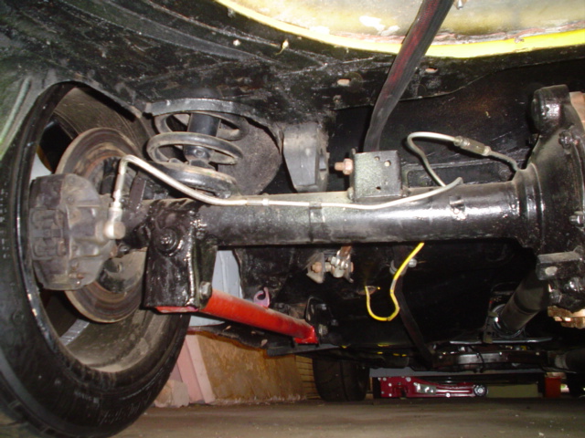

Thanks a lot. That's an impressive conversion. The plan at this time is an Alfa rear end, Fiat 131 trans, and a 200hp engine. I don't suppose you have turbo manifolds for the old Fiat twin cam do you. It might be easier to turbo this thing.

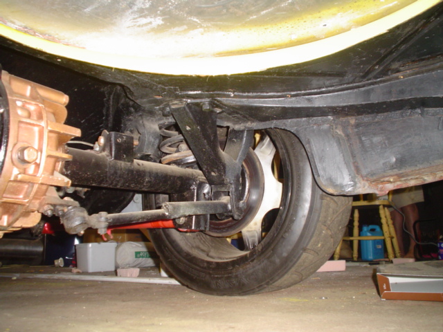

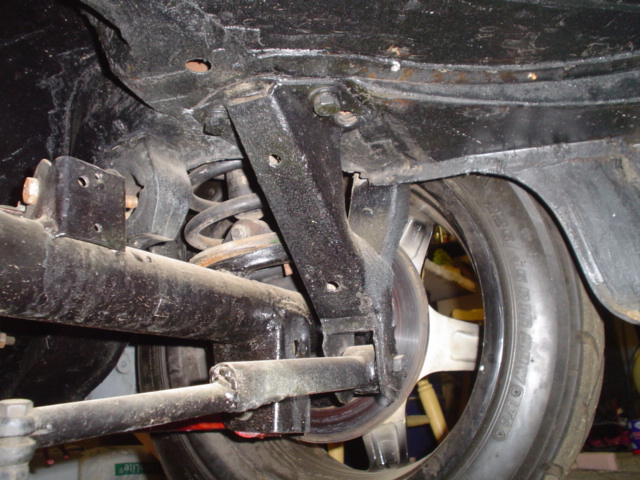

Panhard is a little on the short side there?
1966 GTV
1982 Suzuki "Bathurst" Katana
20mm of travel before bump stop? 8)
The Panhard rod is short, but the car Barry pictured is a drag racer so I don't think it will matter. If this project goes through I will probably do something different there.
