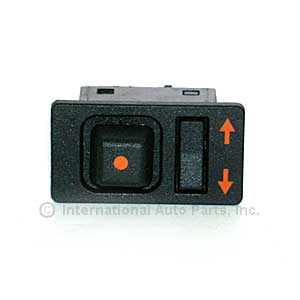

anyone got any tricks/tips on fixxing them..specificaly looking for a wireing diagram for them...the switch in the car is melted beyond belife..ive done a few normal american tests and can manage to get one direction out of each mirror so im fairly certain that the mirrors themselves are fine and atleast part of the wireing is ok as well ...but i cant seem to find a jumper configuration to get the other movements out of the mirrors

well after much tinkering and complete dissasembly of the mirrors there working fine if i run power directly to them...the black wire for the axis solinoid doesnt seem to be grounding or going all the way back to the switch plate wich ever its suposed to be doing that is
any sugjestions of a switch replacement ive heard alot of bad things about the stock switches and was eyeballing a toyota celica switch same wire setup even
If you don't mind creating the wire harness, you could probably use a milano mirror switch and place it into one of the blanks in the small gauge cluster.....

that would be cool...asumeing i could find a millano to scavange off of lol..ive seen some pic's of the millano ones and the toyota unit is about the same style just larger looking....i need to understand the routeing of the black presumably ground wire tho first
IAP has them....for a price (but wiring these is not easy)
