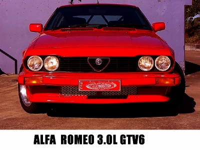

Well it's time to drop the shorts and show you what I got. It's a 164 conversion. Took me about 4 years from plan to floor pan but the pain was worth it. You know it's ok for you guys in the States or perhaps Europe to poke about with these cars because the parts should be readily available being high volume markets.
Try doing it in the land of OZ and you run up the proverbial dry gully all the time. However, even though it is a bit tough sometimes, we sail on 'cause we just love these little bastards. In Australia, Alfa Romeo is one of the smallest represented marques and yet it has the highest club membership of any make on a quota basis ! This is despite the company pulling out of the country for a number of years. That's real brand loyalty for ya.
I got heaps of detail photos but the posting seems to limit them to these few so check out additonal posts to follow.
Anyhow, enjoy the pics and I'll get back to sorting out another BMW in the mountains.. :D

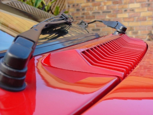

Cabin air intake vents2.jpg (143.92 KiB) Viewed 13920 times
Seamless nose piece.jpg (205.69 KiB) Viewed 13920 times
Engine bay vents2.jpg (136.87 KiB) Viewed 13921 times

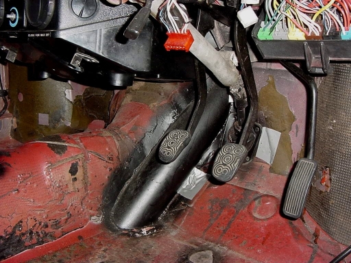

This is a provision to move the exhaust pipes from going under the front cross member and getting flatted all the time to being next to the firewall to prevent that and have a 45 instead of a 90 bend

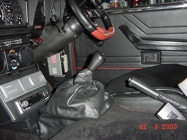

How to fix the transaxle shifter permanently
Selector conversion bare bones2.jpg (178.96 KiB) Viewed 13871 times
ummm, yum.
ummm, yum.
Finished selector installation.jpg (115.73 KiB) Viewed 13874 times

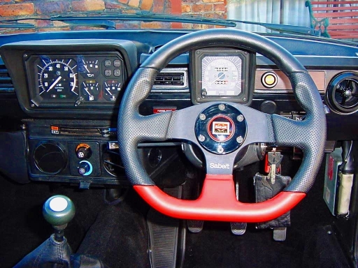

Office before completion2.jpg (176.11 KiB) Viewed 13862 times

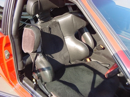

Custom made seat from the original. Reinforced everywhere and use of graded foams in key areas. Covered in kangaroo hide - soft but tougher than Sylvester Stalone
Driver's seat2.jpg (163.35 KiB) Viewed 13862 times

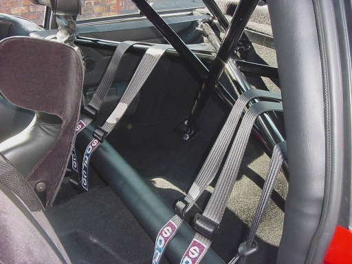

For road use the half cage is better no cage
Decommissioned rear seats2.jpg (156.29 KiB) Viewed 13862 times
..just needs a camera stand..
Roll cage boot view2.jpg (179.03 KiB) Viewed 13864 times
8) have you got more pics of the headers or are you still brewing on that one....
I like the idea, downside is that the inside of the car will become very hot.
Maurizio
I made this provision for my exhausts as I originally had intended to supercharge the V6. I also made a pretty exotic cold air intake sytem to go with that. Note that in the engine bay you cannot see an air cleaner? That's because it lives inside the right hand side front mudguard.
Well, once I got it all cookin' on the road ( and bear in mind this is a road car) I found that the balance between power, and handling was about right for my purposes so I then decided not to go with the supercharger as it was just going to be over the top.
So to answer your question, the provision is there if I ever want to use it but I am currently not doing so. The heat issue is correct but it is possible (and would be necessary) to also install heat shields and insulation of the pipes. The upside is that you never have to worry about flat engine pipes.
I have given myself a challenge to invent a new type of driveshaft for this vehicle and I have a few plans in mind already. If and when that eventuates, I will think about putting on a hair drier on the donk. Until then I am taking it easy on those friggin doughnuts.
