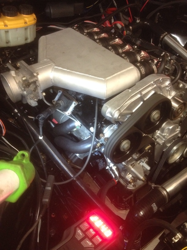

Good luck on the project and keep the pics coming . A mate who I work with has just finished his 75 24v 3.2 . Here some pics to keep the motivation going on yours .
