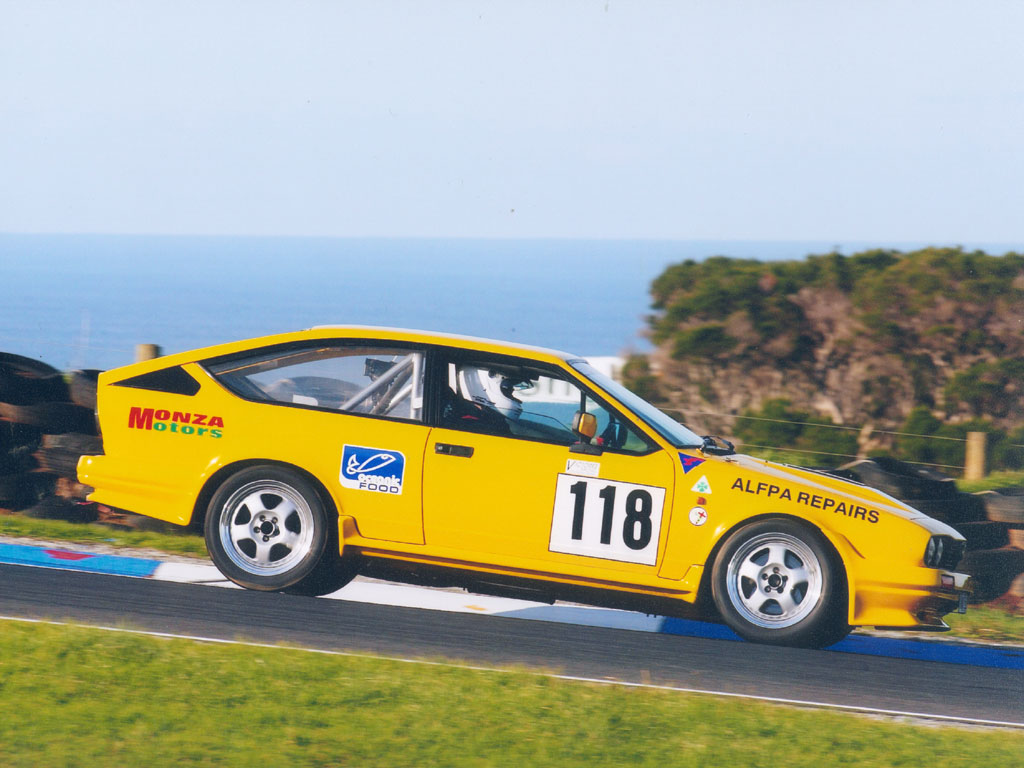

My GTV6 has a 3.0lt 24v that has given faultless service for the past 15 years. It is a road registered car but built for the track. The engine was getting a bit tired now and due for a rebuild. Then my mechanic found a brand spanking new-in-the-crate 3.2lt 24v which we bought and in the process of converting to fit the car.
Most of the add-on bits should transpose onto from the old engine to the new engine (plenum, extractors, Autronic ECU, etc) but just finding a way to convert the 3.2 sump to fit into the GTV6.
Below is a pic of the car at the great Phillip Island Grand Prix Circuit

Love the color!!! :D
