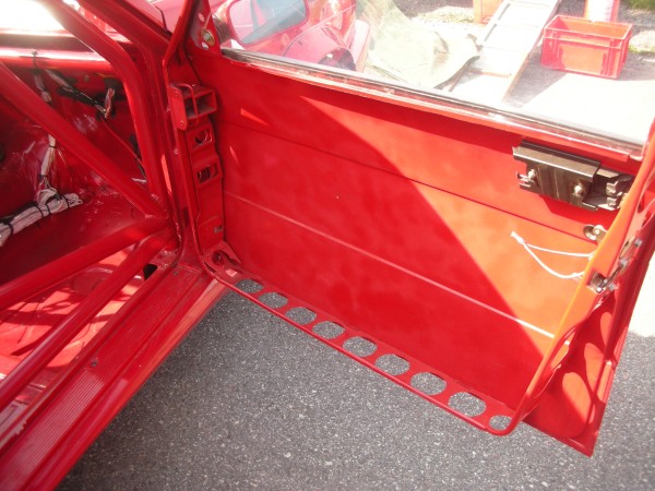

915 kg can you get if you have plastic hood and decklid. rear doors just outer skin (not possible to open). Passenger door like this:

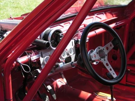

Magnesium oil sump, starter from Alfa 164 V6, light weight radiator+fan, instrumentpanel like this:

I usually do corner weight before every raceday as it is easy to adjust. I have around 250 kg on each front wheel and 200+ on each backwheel (without me in the car).
Engine support is made of plastic and rear chassicomponent of a Mercedes (swaybar support)
In this picture You see it better:
