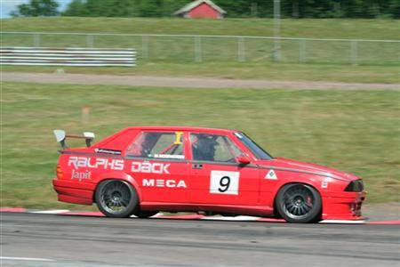

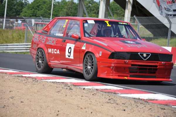

Time to do some updating:
In our Swedish Alfa Challenge serie we have had races on a track called Ring Knutstorp and on a track called Kinnekulle. Two races on each track.
For Ring Knutstorp I had a new lightweigt EVO front on car. This front with a splitter weights only 6 kg. My car worked very well and a managed to win both races. Best laptime was 1.07.7 min
Here are some pictures:

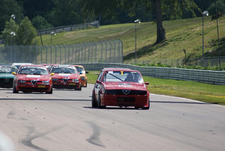

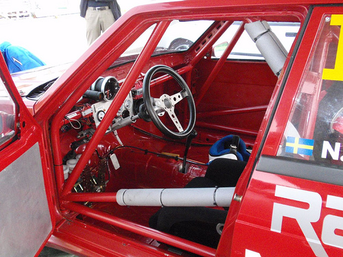

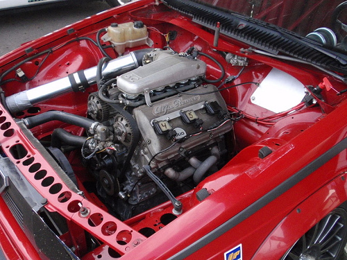

Before our race at Kinnekulle last weekend I had put in a brand new floormounted pedalbox with a brake balancer bar. I also had new pads on both front and rear axle. Front I used Ferodo DS2.11 and Rear Ferodo DS3000. Both pedalbox and pads worked extremly well. I managed to do laptimes under 1 minute. Best time was on Sunday with 59,711 sek. I won both races at Kinnekulle.
Kinnekulle pictures:

Wow Niclas, that sure is one mean machine! What size cilinders did you use for the brakes. I have a 7/8 for the front and a 3/4 for the back, but wasn't too impressed with the increase in feel or performance (pagid rs4 pads). What type of material did you use for the splitter and does it cover the underside of the engine bay aswell?
Also, don't you have cooling issues with all the holes above the radiator? Or do you have some type of ducting?

Dennis wrote:Wow Niclas, that sure is one mean machine! What size cilinders did you use for the brakes. I have a 7/8 for the front and a 3/4 for the back, but wasn't too impressed with the increase in feel or performance (pagid rs4 pads). What type of material did you use for the splitter and does it cover the underside of the engine bay aswell?
Front brake I have 0,70
Rear brake it is 0,75
You usually should have a "smaller" cylinder to front brakes.
My "splitter" is 4 mm plywood (pressed wood) and it overlaps oilsump (front) with just 2 cm.
Cooling is OK but I get a lot off air into engine bay so I usually needs some addessive tejp to keep the hood on the car in higher speed (above 180 km/h)
I will look into this and do a better design off air flow.

Re: Niclas Rosengren (Sweden)
Very nice indeed. :)
Looks like Johans car was leaking pretty early in the race? At least judging from the first picture in your post. :(

Mats wrote:Very nice indeed. :)
"Under minuten" is seriously fast, about 3½ seconds better then my time on a ~1min lap. :wall:
Hmm, You are probably right about Johans car. You must have eagle eyes. :wink:
