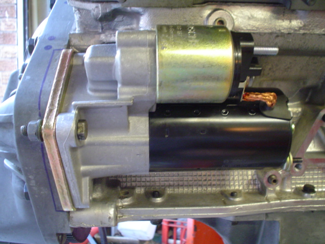

Jim, how much lighter is the Motronic starter?
Does that mean the 164 starter is different again?
So there's the L-jet starter, the SZ/QV starter, and a 164 starter? Is that right?
Starter conversion.-164 or 156...

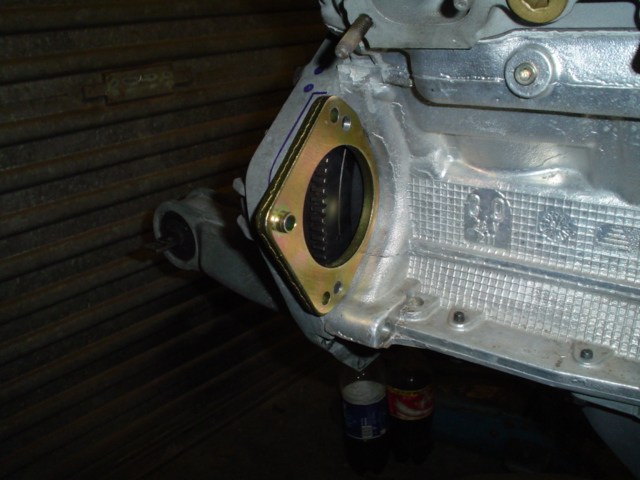

Aargh ! This was setup pics,not finished product..will find finished pics.. :(
Yes there are 3 different kinds (maybe 4 if the 164 also had a lump earlier on). Gtv6/75 V6/SZ have 2-hole flange, 164 has 3 holes. Barry's trick adapts the 3-hole part to 2-hole use.
New starter (75 V6 Motronic, SZ):3.5kg.
Old starter: 6.5kg
Baz,
Can the 164 starter mod be done while engine is in the car if you ship me one of those plates? I have a spare 164 starter. If not I'm giving Vince Bachu a call. :D
Zman,unfortunately no..see the blue marker area? needs to be cut out or machined away for everything to fit.
Nothing is that simple Im afraid.... :cry:

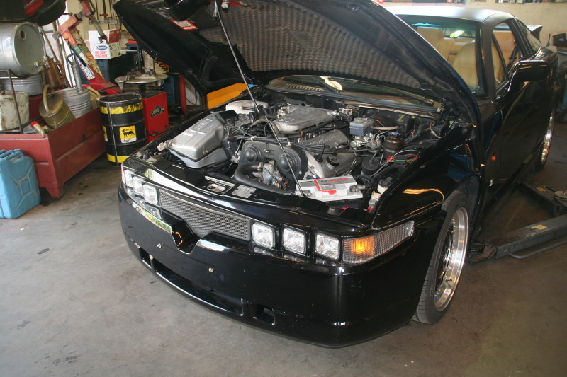

finally, the 3,7 conversion has started today :lol:
some parts are not yet here, but they will appear shortly.
engine went out today, tomorrow 3,7 in :lol: :lol:
can't wait
this mechanic is very good!!

Man, you're living my dream! (except mecanic) :lol:
Hope that everything will go smooth and fine!
i would shoot my mechanic if he came near my car with that kind of tool... :D
Looking forward to the result, we want lots of pictures and movies. 8)
