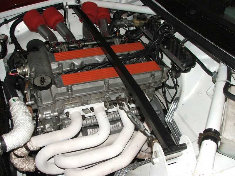

Mats, here is one way on the Cab.
- Copy of 20 Engine exhaust side.jpg (67.3 KiB) Viewed 7431 times

MD: sure, the engine lift points on the ts is easy. Nord is not that easy. Not sure about loading the head gasket either...
