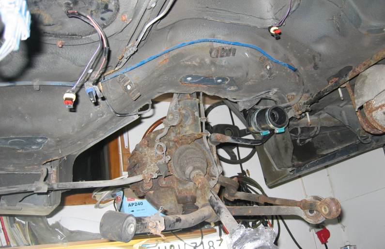

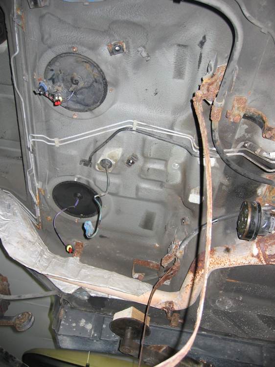

Micke - any chance you can snap some pics of how the rear rails kick up over the rear driveshafts in a Q4? Been daydreaming a bit about converting one to 4wd using bits of the integrale/155 driveline, or even building a rwd one... lol.

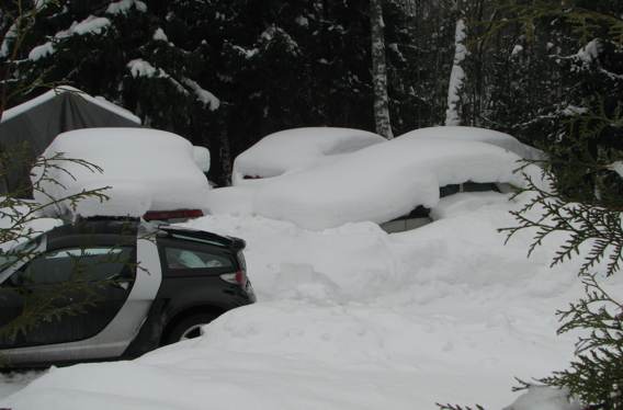

I have some photos. Hope they help. If not I'm not likely to get any new in a while as you can see in the latest one.

Thanks Micke - doesn't look too different from what I recall the normal 164 pressings looking like last time i was under there...
