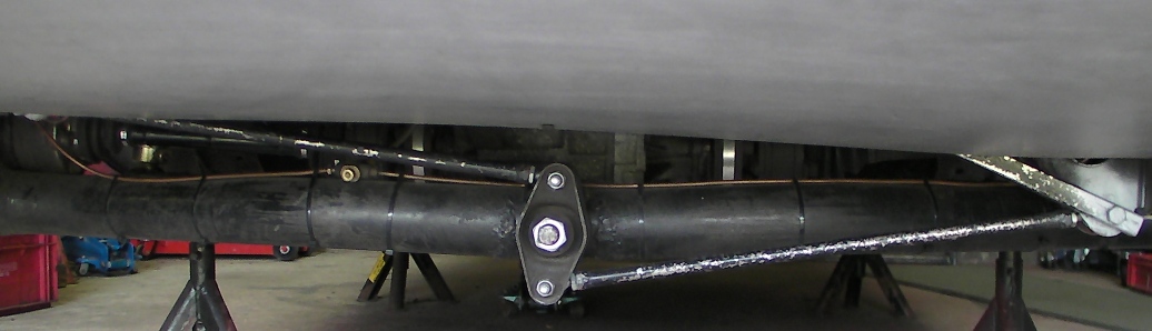

Here are some pictures off rear suspension
I do not have any rear swaybar (like the SZ and RZ). For me this works fine.
Rear chassi setup:
Total toein 4 mm
Camber 2,5 degree

Re: Niclas Rosengren (Sweden)
Nice, lowered rear roll center.
Also do all Swedes bend their DeDion's in the middle? :D
Any sensible 116 driver does it :mrgreen:

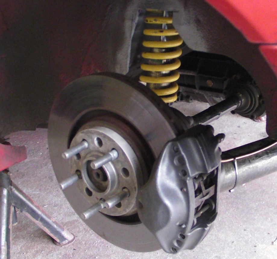

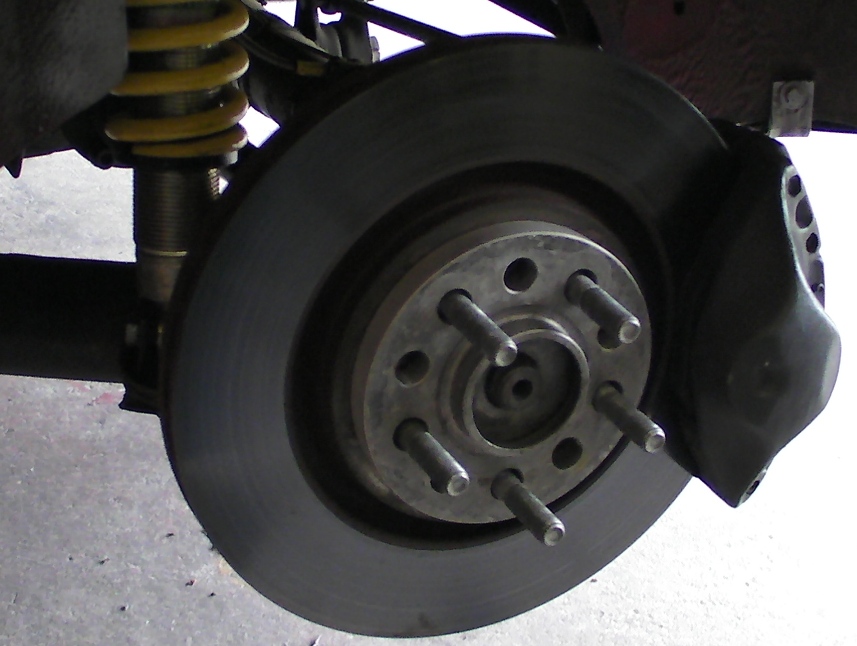

One thing bothers me enormously when I look at the front suspension photo's - the drop link for the steering arm connection. I appreciate it's there for a reason and gets the steering arms working more horizontally, but even though it's probably welded up the "double right angle" nature of the drop link looks MASSIVELY prone to flexing and subsequent failure. How does it not flex??
To be honest that single item scares me, although all the rest of the work looks just excellent!

Please notice that Niclas has moved the rear springs. This changes the MR and thus the situation is far from standard. What might be good for a stock car doesn't apply anymore.
Hi Steve !
Steering arm and knuckle are conected with a M14 (14 mm) bolt. Around this bolt I have a steel sleeve with OD 18 mm. I secured the bolt with an extra looking nut. Sofar there have been no flex in this joint.
But I do understand your concerns. But if you dont try you will not know if it works.. :wink:
