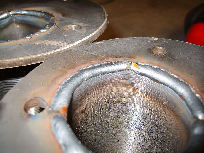

Anyway, welded up the spring perches yesterday. The flash adds weight not only to girls obviously, the welds doesn't look as fat in reality.
Swedish midsummer is something you need to experience first hand to understand.
- Bet they won't fall apart though...
- springseatweld.jpg (95.79 KiB) Viewed 6899 times
