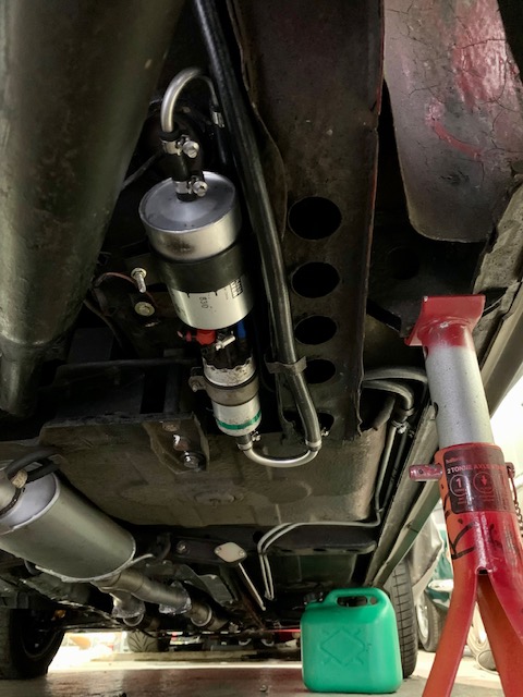

With the limited time and travel restrictions in lockdown I have atleast managed to carry out quite a lot of maintenance work on the 3.0 SA carbi GTV. A couple of years ago I restored the entire front end with new bushes and Powdercoating parts before I drove the car to Zandvoort for the Spettacolo.
This car has been totally untouched underneath with no spanner ring marks on any nuts and bolts, however I have made a decision upon stripping each component to have all these nuts and bolts plated back to new factory colour. If this car was still in SA I would not have bothered but I can’t risk any corrosion on these parts now that the car is in a the UK. Having said that it never goes out when their is salt on the roads
The replacement fuel lines was first on the list from the tank to the engine bay . With the changes in fuel it was critical to make sure the fuel hose was compliant with the new regulations. Nothing worse than having a fire in a classic car then your insurance turning around saying they won’t pay as your fuel lines don’t meet current ethanol protection standards blah blah ..
I had some stainless tubing bent but as no new pipe can handle that 180 degree bend without collapsing and this occurs mainly on hot days under the car . ( common problem I had in numerous cars in SA).

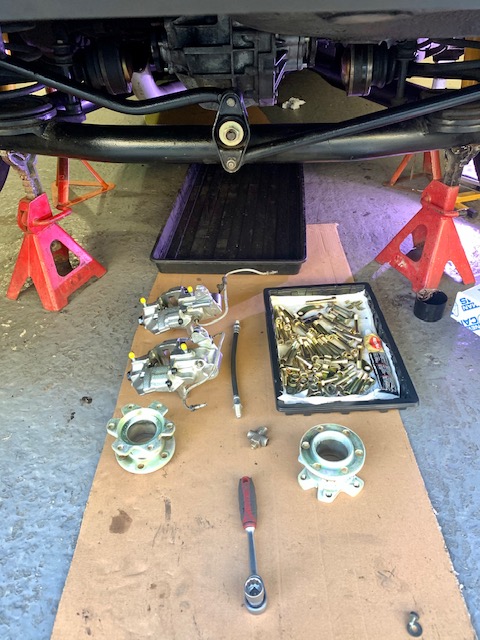

Next up was the rear calipers . This I had no choice as I had a leak in the left one and thought either I service one and then wait for the other to leak OR just replace both with new calipers. My old calipers were still in lovely shape with zero corrosion so I found them a new home with someone who was prepared to service them properly. I took the lazy route and waited for my delivery from John at Highwood to send me a pair . All of two days waiting
The discs were also replaced even though they had only 1mm in total wear. All the inner side shaft nuts and bolts were re plates.
Of course thanks to Jose for his assistance working in 2degrees half outdoors in November.
I’m still amazed how clean the gearbox still is after all this time and it’s never been out. Synchros are all still perfect. I did replace the clutch and slave back in 2013 so I have covered that area.

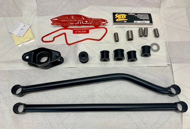

Last up on the rear end was the watts linkage . As you cannot get the original bushes which I prefer, I had no choice but to use the aftermarket poly bushes . They are really good but nothing wrong with the shor hardness of the OEM part. One these were stripped out it can be seen I wasted my time as all the bushes were still perfect but atleast this gave me an excuse to tick off the returb items . The centre dedion bushes is still totally solid so not touching that !
No luxury of a hoist, just move the car to edge of slope outside the garage door and hopefully it does not rain.
