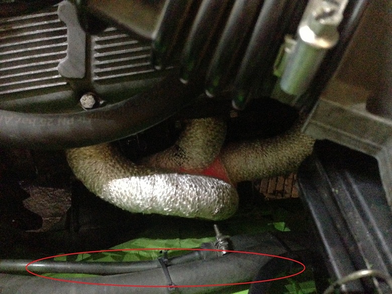

Than I´ve discovered fuel lines route that goes quite close to the headers (see the pic on AFM side). Is this a normal route?
Re: Andy´s ex-white GTV6 (CZ) - pearl green

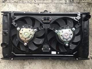

There is a lot of fan replacements out there . Best I used was the 156gta fans . They fit nicely but just need to centre correctly to avoid the thermostat housing . Other cheap fan was the single fan from a Kia Shuma . Not sure which model but really good shape blade and designed as a proper pull through fan . Your fuel lines should come up against the body but I always sleeve them with heat sheild just to be extra cautious . .
Pic attached with gta fans

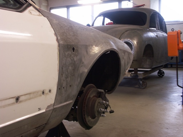

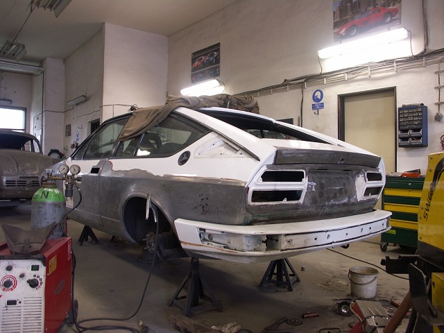

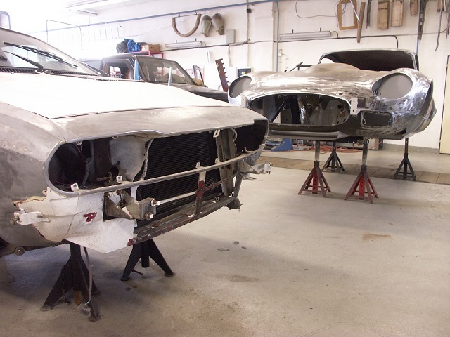

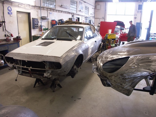

I´ve also found some more pics from car bodyshop on my comp.

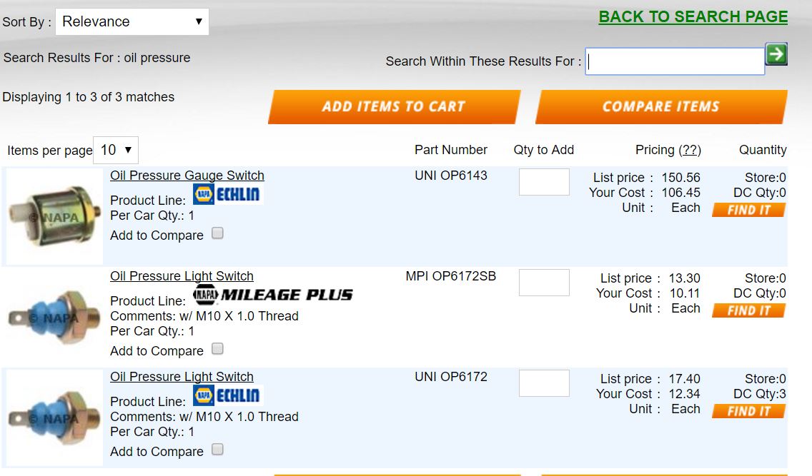

Andy I just checked Napa - Canada .Can't help myself, I'm sick that way. They have 3 options for sensors.First one is a little expensive.But it's a direct replacement.Other two will work, might have to modify your wiring terminal,

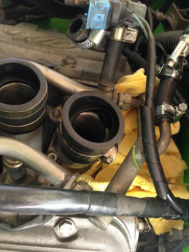

update: today morning the engine started just fine (while cold), after 2 minutes engine started to die (coolant temp about 40°C), therefore disconnected CSI and manualy choked rpms (by throttle cable) for about 30-60 sec. (engine did not really liked it, smoke from the engine bay) but after this it´s been idling fine. While coolant temp reached 70-80°C I´ve decided to switch the ignition off. Let it sit down for about 15 minutes, connected CSI back and was not possible to start the engine at all. Let it sit down for about 30 minutes, engine started up but than again started to die quickly. When pushing gas pedal down it really did not work and engine switched off.
fuel pressure measured - OK, distributor cap - OK, spark plugs - not really OK, they are black (time to replace valve cover gasket), therefore I´ve just brushed the carbon out at the moment from spark plugs.

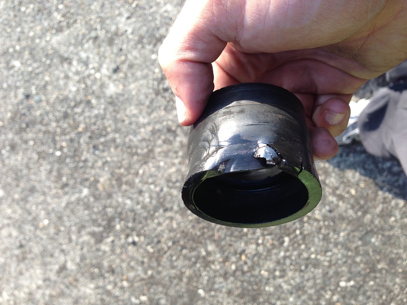

However removed intake manifold and found this:
