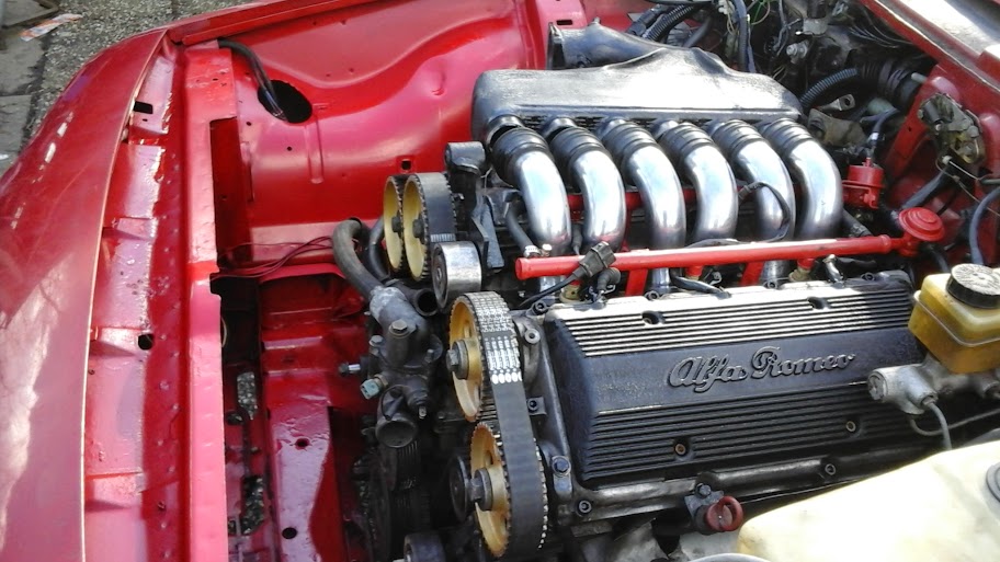

Lighter always wins . Your cross brace in engine bay to engine is excellent . Very clever . You have the diagonal brace back to firewall and then combined to keep engine braced . The one does not interfere with the the other . I'm gonna steal that idea , I hope you don't mind .

steal away.....
i've used aluminium rods wich are treadcut (?) on the ends. all is easely removed. actually , i did it before on the gtv turbo, it realy helps stiffening up. i still want to brace the frontbeam on wich the swaybar is mounted

could you take more detalied pictures of the engine/shock tower brace?
how does it attach to the engine and the chassis at the fire wall and the shock towers?

i have extended the bracing in the enginebay to the front and castorballmounts in preparation of a 32mm (hollow) stabi (swaybar)
