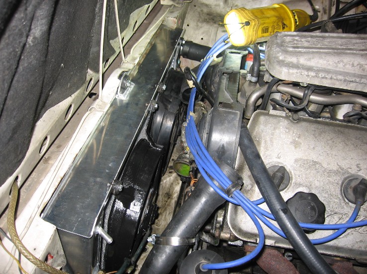

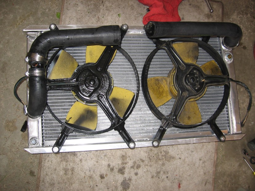

I purchased the IAP aluminum radiator. Very nice unit, fits almost perfectly except when using stock fans, the lower fan mounts touch the body. The IAP radiator comes with the necessary two studs on the bottom. These fit perfectly and the original rubber spacers fit them as well.
The top mount needed some grinding to get a good fit. I used the Centerline radiator two piece rubber spacers (for the older alfas...7$). fits perfectly.
The IAP radiator comes with a drain cock, no way that was fitting in there. So replaced it with 1/4 NPT plug. No issues.
The fans and radiator are a tight squeeze when installoing and you have to remove the thermostat housing sensors. Temp sensor very close and I may trim the fan housing a little nex time around...
Fired right up and no leaks this time!
Now both fans work...kick on at ~190-195. Thermostat opens at ~180 or so. Everything actually working just great for once!
