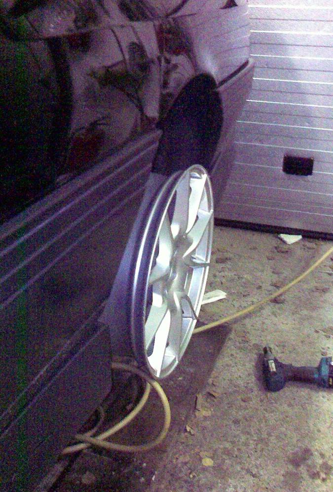

I have 235mm wide race rubber (usually 10-15mm wider then street rubber) on my 9" rims and when I stack the wheels the tyres doesn't even come close to touching each other.
Like this
Tight you say? You should se it with simulated roll...
Like this

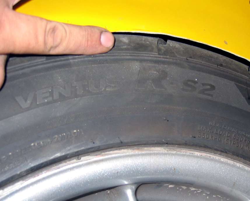

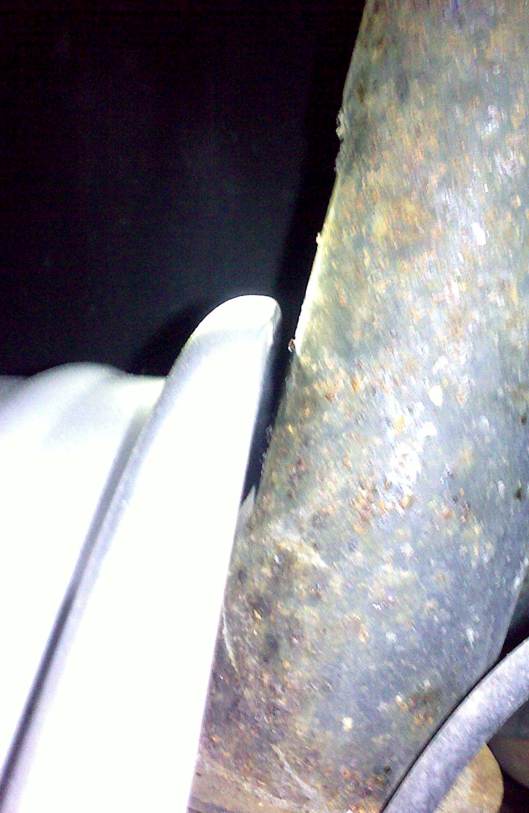

Heh. You call that tight.
And yes. 9x18 fit the 164. Sorry for sucking photo quality. (and dirty finger)

Re: Back again...
Fibreglass fenders doesn't count...
