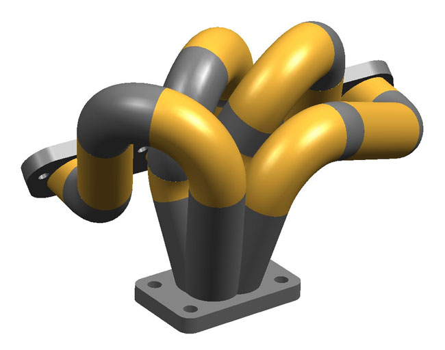

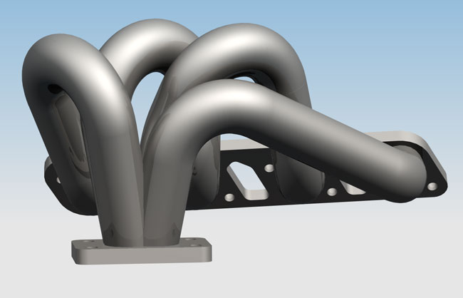

Re: Mats Strandberg (SWE)
And here is the verison showing how it's split in pieces.
And aother shiny one.
- split in individual parts
- grenror-klar01.jpg (31.01 KiB) Viewed 6632 times
- mmmm, shiny...
- grenror-klar13.jpg (22.8 KiB) Viewed 6633 times
SS steel or mild steel ? when i weld make headers i prefer mild steel flanges and inox tubing. SS flanges especialy thick ones warp alot
even with 2x6mm flanges instead of 1x12mm still warpage is significant.
SS2333 (AISI304) tubing anyway. Not sure about flanges actually. Warp alot you say? TIG?
You need to mill it afterwards of course. But you mean it warps in use?
warp during TIG welding, no problem with warping in use. i am sure your welder knows his jobMats wrote:SS2333 (AISI304) tubing anyway. Not sure about flanges actually. Warp alot you say? TIG?
Not his first stainless turbo manifold so I'm sure it will be fine.
Quite long and "temp neutral" shape too, at least compared to the incredibly short and compact bike turbo manifolds he is used to.
