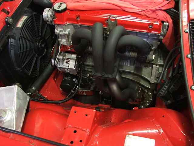

It's a TS engine in my Alfetta race car.
The stage one of the headers terminate where you see them now into a coupling plate to stage two. However it could be a place for a turbo instead.

Re: Mats Strandberg (SWE)
Mats,
Here's the finished item again. Plenty of clearance all around for turbo.
- TS headers.jpg (26.88 KiB) Viewed 5793 times
Yes, plenty. Can't believe how much room that narrow head creates.
You would probably have clearence issues between the #1 primary and the compressor housing though, but that's an easy fix.
Looks nice to have the steering column on the right...
