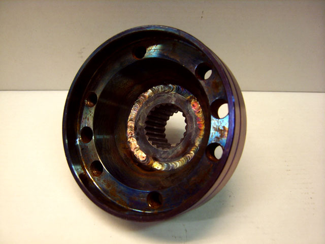

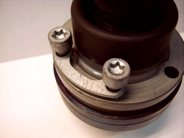

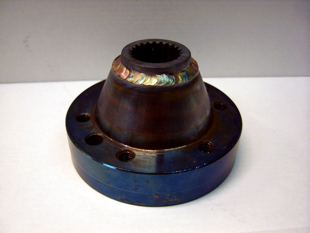

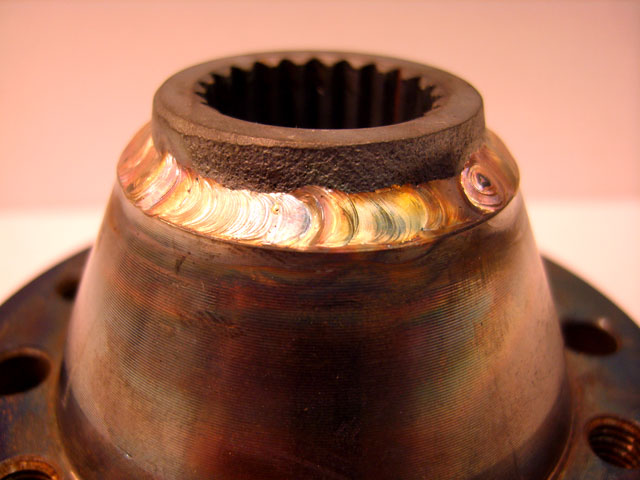

The rear flange has arrived.
Some rust from the spark erosion, this is an actual part from an existing car modified to fit the Alfetta clutch axle. The center that is welded in is from an old alfetta tripod.
- Front, looks the part, nice welding.

- Back...
- rr-flange02.jpg (38.77 KiB) Viewed 6832 times
- Looks nice anyway...
- rr-flange03.jpg (57.25 KiB) Viewed 6829 times
- Heat treated after welding.
- rr-flange04.jpg (35.03 KiB) Viewed 6830 times
- OEM hardware, nice.
- rr-flange05.jpg (42.05 KiB) Viewed 6832 times

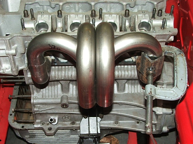

Re: Mats Strandberg (SWE)
..sort of reminds me of one I have seen before..
- Header 2.jpg (207.99 KiB) Viewed 6412 times
What kind of head is that? Engine looks Nord but thathead looks quite different to what I'm used to.
Nice smooth flowing runners but will it fit the engine bay? Looks like the turbo will come out pretty far from the engine.
My turbo is very close to the engine and it is still only just clearing the body...
Maybe it's a size thing?
- Maurizio
- Posts: 680
looks like a ts head, distributor opening on the backside of the exhaust side.
