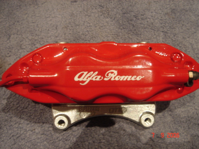

this one?
second series gta
disk 330mm and 32 mm thick
second series gta
- brembo gta 2e serie 006.jpg (134.89 KiB) Viewed 7121 times
Re: Mats Strandberg (SWE)
brembo
- brembo gta 2e serie 010.jpg (156.95 KiB) Viewed 7120 times
Nope, but similar. Mine has the crossover internally so no pipe and the brake line goes in at the end. Takes up to 28mm thick discs, slot is 30mm wide.
These are not originally from an Alfa.
