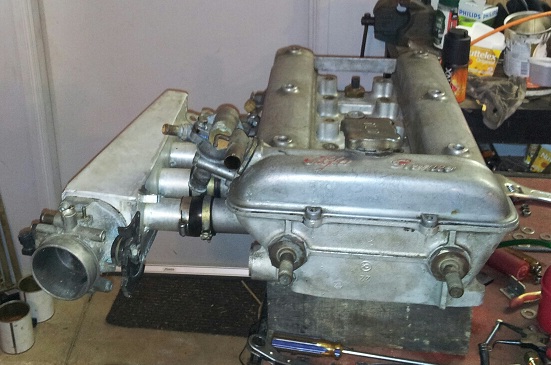

And finally the new head is ready to go on:
At the rate I work, there's a good chance the car might be up and running by mid 2014 :oops:

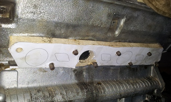

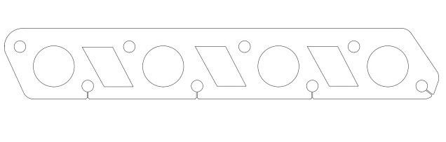

Back around the time of my last post in this thread, I was toying with the idea of turbocharging so I taught myself just enough CAD to draw this up
nord exhaust flange
nord exhaust flange
Then printed it out and glued to a piece of chipboard to see how close I was - imagine my surprise when the holes lined up with the studs
template
template

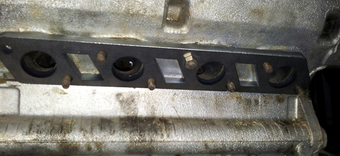

So I then had half a dozen of them laser cut. It's one of the few things I've farmed out on this build, but my little plasma cutter wouldn't have coped too well and it would have taken me forever to do on the mill
flange test fit
flange test fit

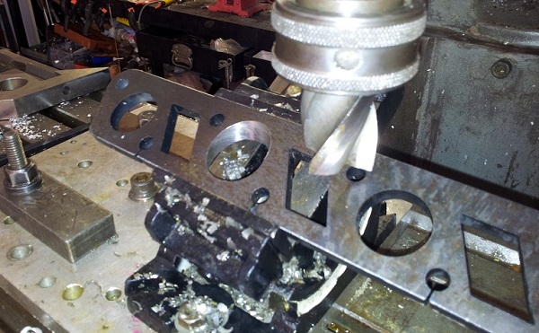

Next step - bore the exhaust ports at the correct(ish) angle:
boring work
boring work

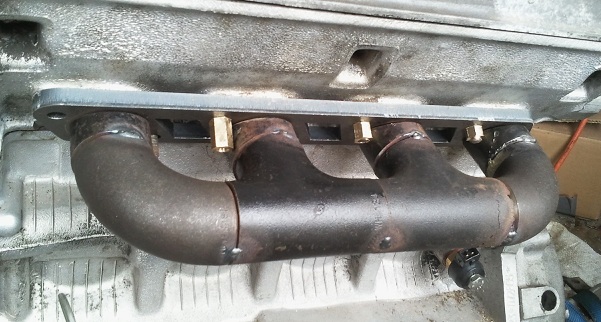

Seeing as I have no intention of chasing crazy horsepower, a log manifold will do for now
There wasn't enough clearance for some of the nuts, so I had to make some new ones that are 11mm across the flats. Now I can add "custom brass nuts" to the list of modifications :twisted:

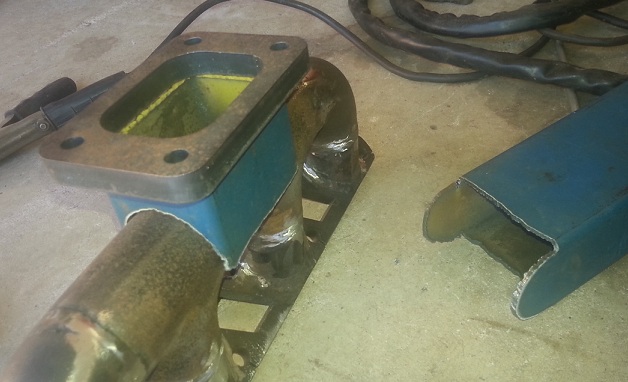

Next up - add a flange for a T3 turbo
Finish welding it all up, machine the face flat, and a quick coat of high temp flat black
done
done

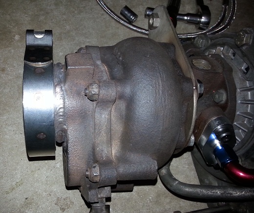

Then onto the turbo. It's an old Garrett TB0356 off a late 80's Saab. It was free, and appears to be in pretty condition where it counts.
It has a bespoke outlet stud pattern (and the studs were wrecked anyway) so I grafted on a V band flange instead

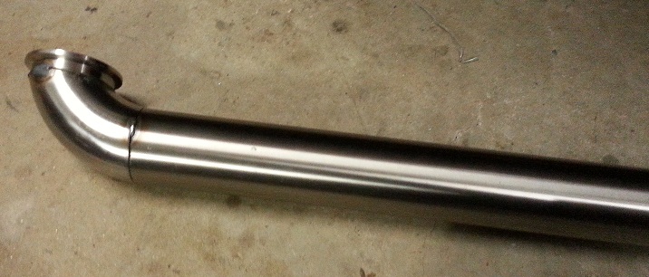

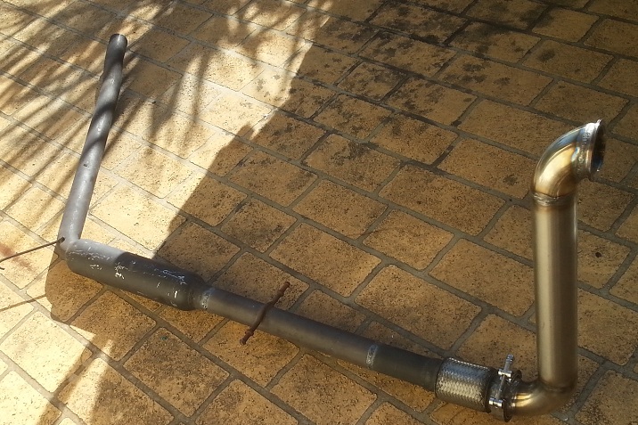

Started work on a 2.5" dump pipe
And my very intricate exhaust

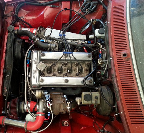

then skip over a whole heap of dramas and distractions to how it sits today

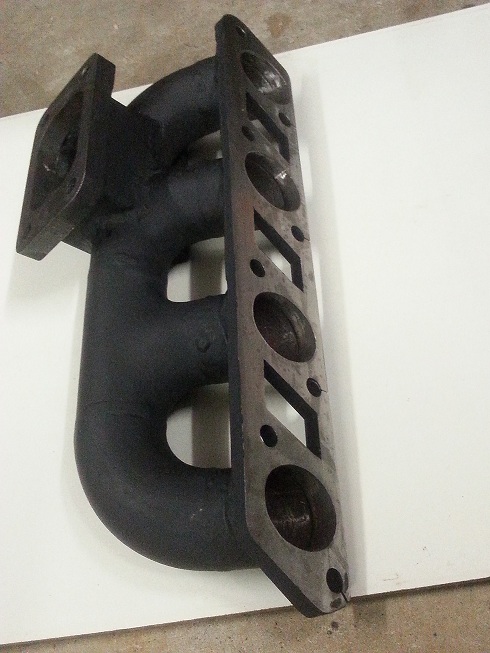

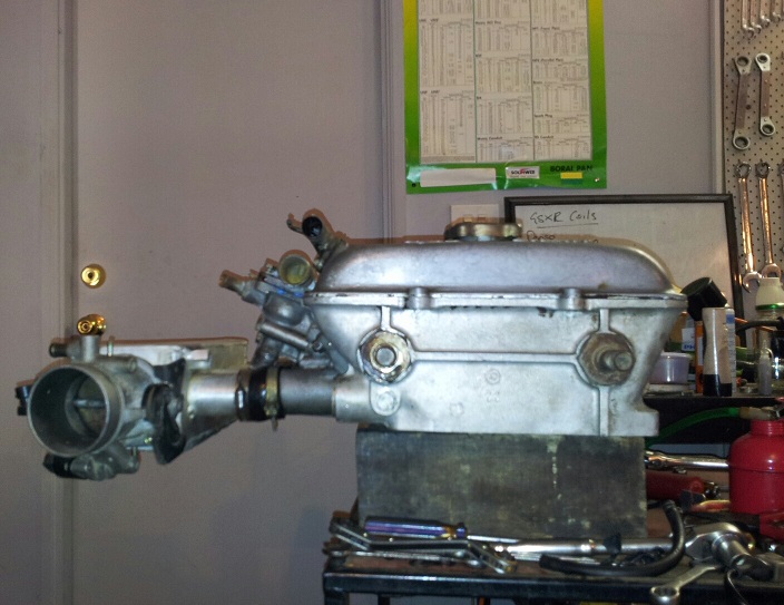

Re: festy - a pair of alfettas down under
Hey Festy, nice work but why go about it the long way? All you had to do is ask and I would send you a 1.8T log manifold! We have some around here and the early single-plane versions are of no use as everyone looks for the later two-plane type. Damn, you would have saved yourself lots of time -unless you like the exercise that is! 8) In the pic below you see the two factory versions, early on top, later (and expensive) bottom. Early ones were prone to cracking which is not the case with later ones. All with T3 pattern.
