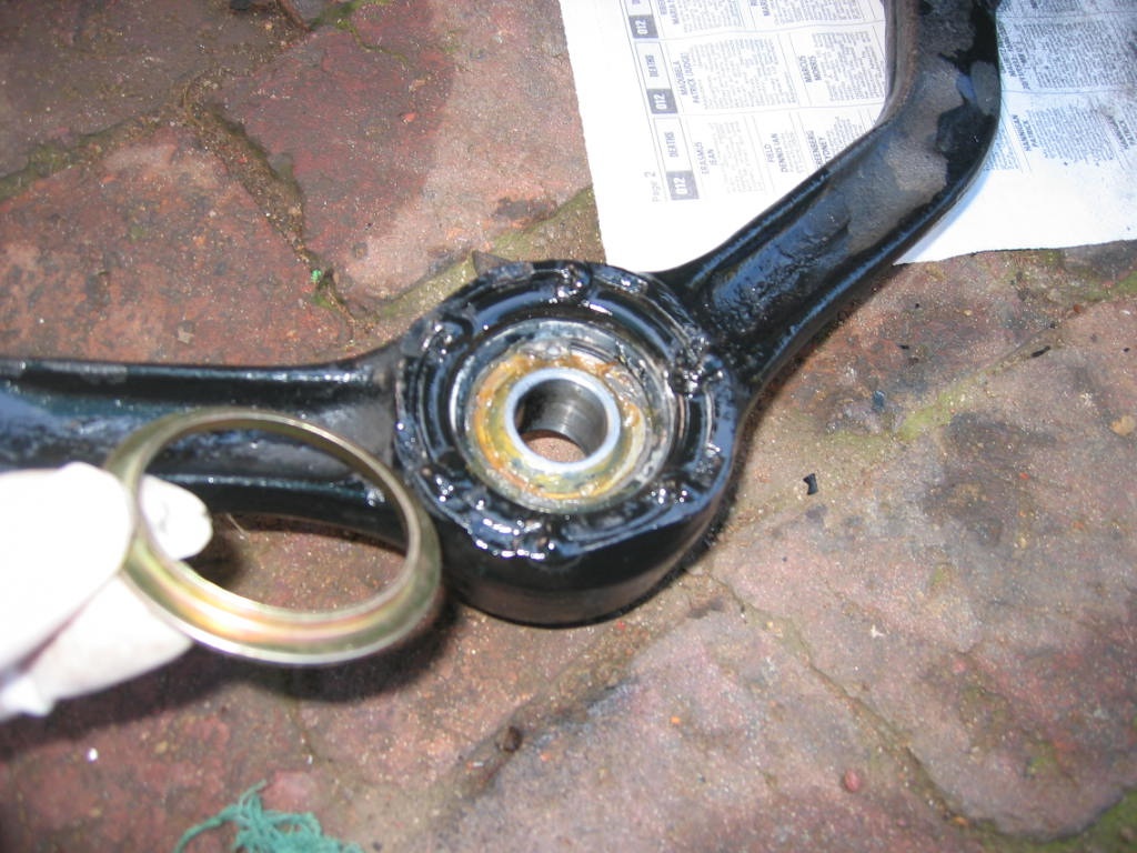

I´ve also found the reason of the noise - center de dion uniball damaged, therefore the front of the dedion is moving up and down a knocking :-/ ... I know Performatec and RSR is making SZ uniballs, however the price is too much..therefore I´m thinking about superflex http://www.superflex.co.uk/products.php?cat=17&pg=2

I have used both uniball from RS and the poly bush from performatek . I have had no problems with either . The uniball is much harder to install as I needed the Dedion to be out so I could heat the tube . Also I added a spacer in to prevent it from sliding up nd down .
The poly bush also needs a tool which can be home made so you don't cut the bush . Make sure no sharp edges . I think Greg had issues with poly bush but can't remember . We have them in most of our race GTV due to cost of uniball and ease of installation .

If using RS uniball you need these clips which you can order but need a spot weld on top .
- image.jpg (220.72 KiB) Viewed 18931 times
