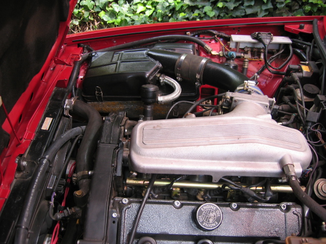

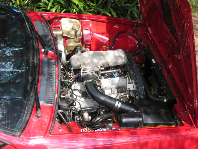

pic 3 Original 1985 GTV 3.0L (only 212 built)
pic 4 Restored 1984 GTV 3.0L ( seven made in charcoal and three fuel injected)
pic 5 was 2.5 now 3.2 GTA conversion
pic 6 was 2.5 then 3.0L twin turbo now 3.3 24v using 3.0l crank porsche pistons on an existing 156 2.5 24v engine.

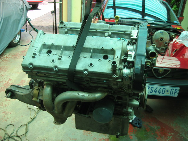

This pic is on a Saturday morning at my folks place before work commences on pulling the 3.3 24v motor out my oldmans GTV. Its got a water leak into the oil. This pic was taken a while ago and we still have not isolated the leak yet.
Engine out after four hard hours.
Another pic of the GT. Anyone figure out what model(engine) it is and why?
You lifted the engine out with old timing belts?? :o
Mats, dont worry I selected the best of my old timing belts. What normally concerns me is the shelving rack it hangs from.
