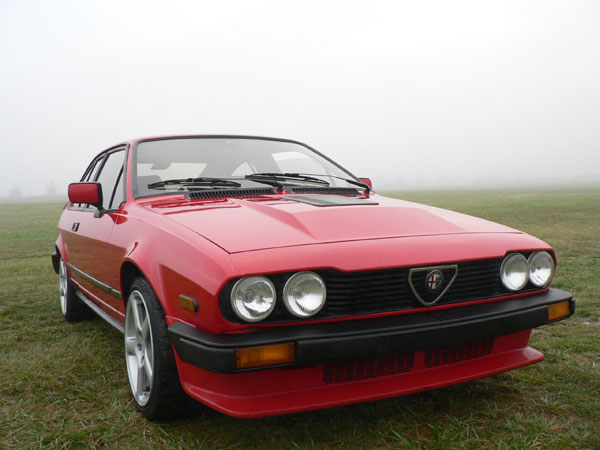

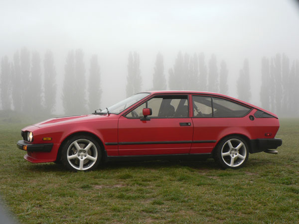

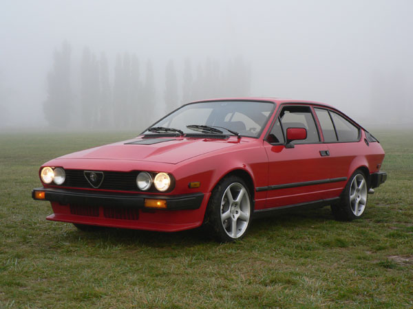

Here is a pic I took yesterday morning, at dawn just as the sun was rising. Note the Euro bumpers :D
Seattle, September 2005

Euro bumpers
Vince in the UK (http://www.gtvince.com/index.html) sent me a set of Euro GTV6 bumpers a few months ago. The look (to my eye at least) of Euro bumpers is great and I reckon I got a good performance improvement at the track having removed my US bumpers. I was really amazed how much the US bumper assembly weighs since I put them in storage in my attic ... fully assembled with brackets and shocks etc then had to heft them up into the attic - not exactly easy to do :shock: . The euro bumpers are much lighter.
Thanks again to Vince for finding this set for me (I understand that they are becoming pretty rare now).
I painted this set black to match the trim on my car.
