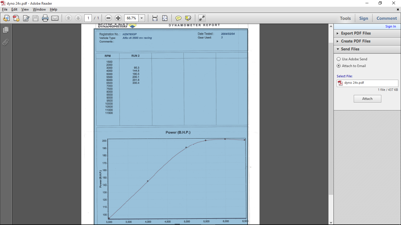

Hi .... As u know I have a 3.2 GTA motor in mine... a wonderful beast.... especially with the light weight.... I have NOT measured it, but when I drive it feels pretty damn close in performance to the 4.0Lt V8 M3 .....
Mine has about 205-210kw at flywheel... most of the work was done by our local GURU, Dawie, at that stage with some help from Kevin
Re: My rebuild!
Dyno sheet
- dyno 24 3.2 gta - 1700mt altitude
- 24 dyno.png (181.36 KiB) Viewed 15826 times

hi....
mostly balance all parts, ECU, Exhaust and a VERY slight head skim....

Re: My rebuild!
Thanks Joe- that's awesome work considering the altitude! Wonder how it would go down in Durban or CT?
