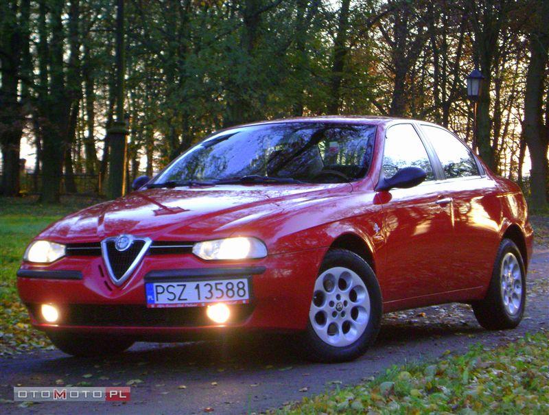

Since I see you guys posting pictures of other alfas too, then it's my turn. Bought her just few hours ago, a first stage 156 2.0 TS - lighter and more powerful than later 156s. I was looking for something practical to haul my arse around, and it ended up in the usual way :lol:
And few pic from previous owner:
