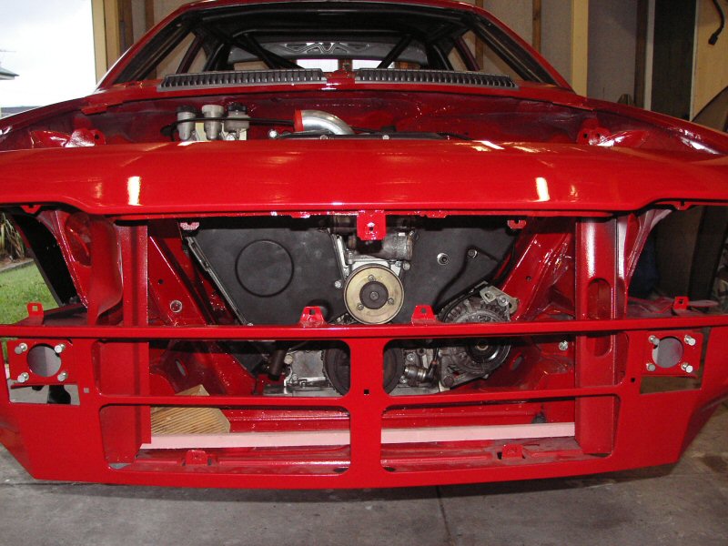

Hi Daniel,
I really like your paint job and color. Looks really clean. Your hood looks awesome. How did you modify it?

Colour is Rosso Alfa from the 156/147 range. It is a little lighter and brighter than the 1984 red. I wanted to stick with the '84 style 2 tone and I always wanted a red one (faster too :lol: )
Most of the prep work was related to the bonnet mods. The rest of the car only had a few small spots of rust (not bad for a 22 year old car that has spent its last 10+ years in the weather) and the obligatory car park door dents.
Note to self (and anyone else interested in listening) - be prepared for a lot of work when you attack a bonnet (or any other large flat panel) with a grinder and welder. It took MANY hours of work to make those vents, weld a panel in the centre, weld the vents in and then get it all straight but it's all a labour of love.

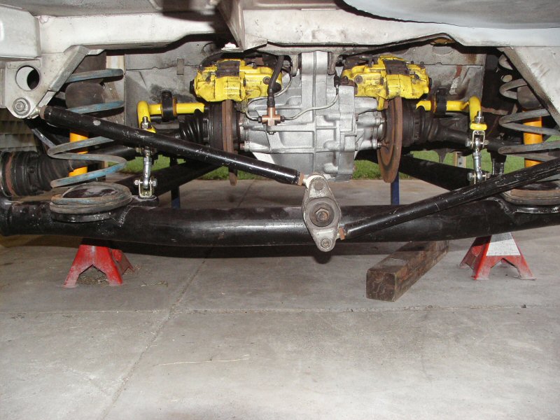

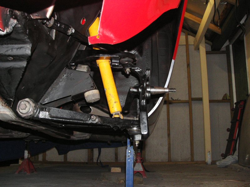

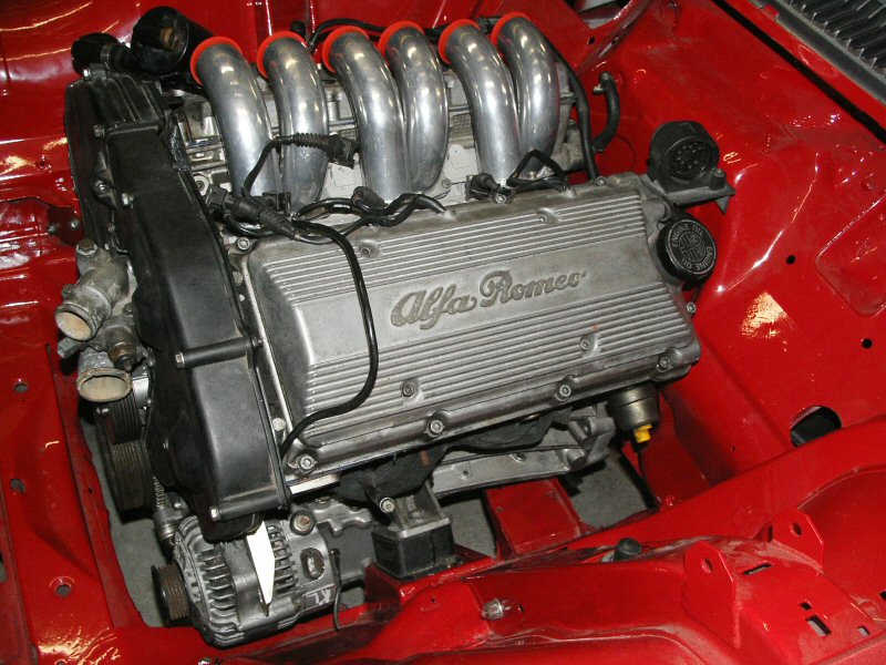

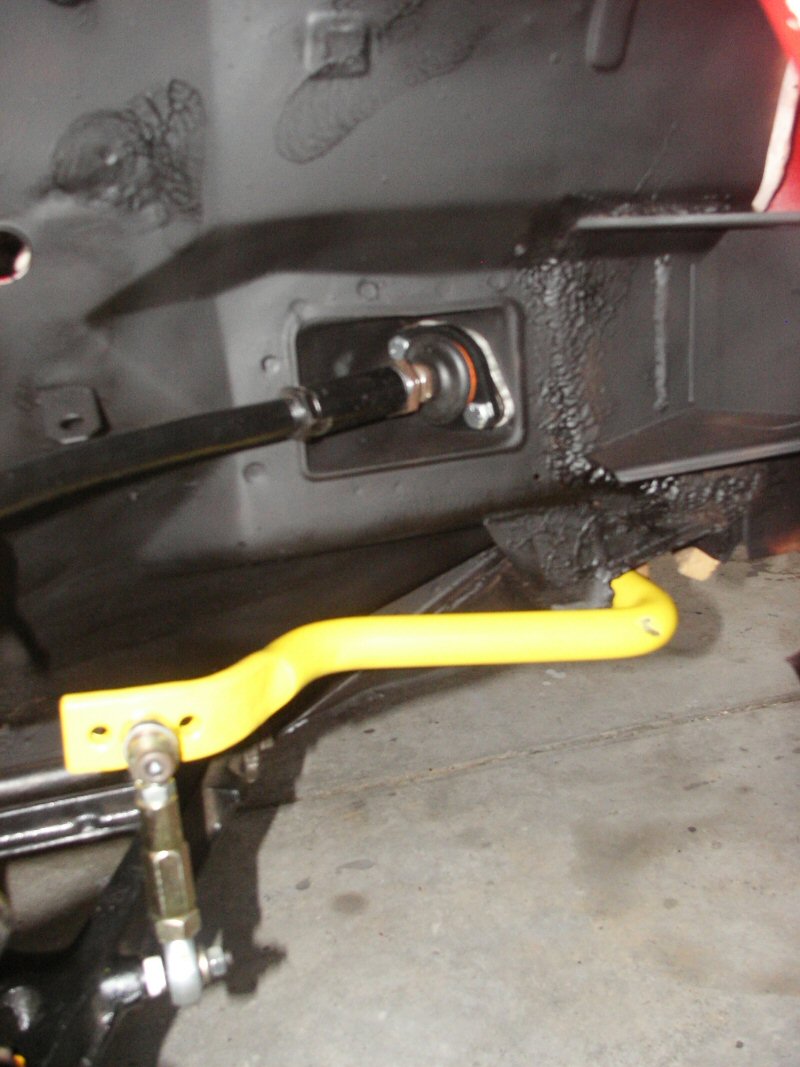

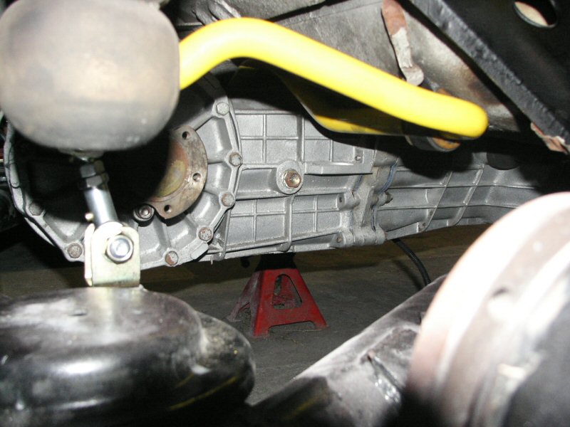

Waaaaaaaaay too long since any real progress, so....
Today the engine and driveline went in !!! :D :D :D :D :D :D :D :D :D
Front suspension (less T bars) is also in and the drop spindles do wonders for the camber gain.
A few pics to get started (I have 2 more days off work to get a sh1tload more done) 8)
The 24v heart in its natural resting position

Trans & rear AR bar
Trans & rear AR bar
08-01-13 005.jpg (89.82 KiB) Viewed 9326 times
Front Left
Front Left
08-01-06 006.jpg (96.47 KiB) Viewed 9329 times
Front Right
Front Right
08-01-06 011.jpg (93.34 KiB) Viewed 9332 times
Fark yeah mate lookin good!
Hey Dan, where did you get those drop spindles?? custom made?
:D
Daniel
Posts: 276
Post by Daniel »
Like almost everything else on my car - custom made by me.
It's easy to do if you have access to the right equipment.

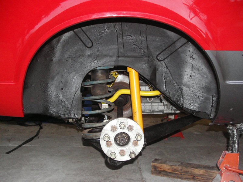

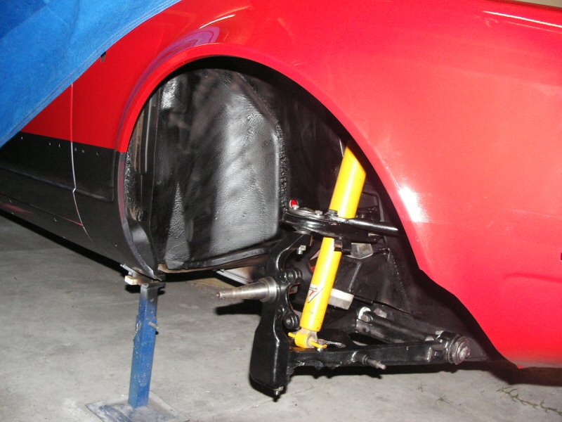

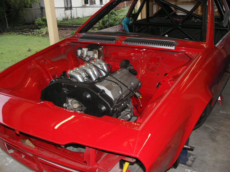

Here's some more shots of the weekend's progress - the whole driveline is in, as is the suspension.
Front Right
Front Right
08-01-15 023.jpg (121.12 KiB) Viewed 9210 times
Rear Right
Rear Right
08-01-15 005.jpg (106.36 KiB) Viewed 9209 times
Transaxle
Transaxle
08-01-15 007.jpg (115.1 KiB) Viewed 9209 times

Engine in !
Engine in !
08-01-15 001.jpg (114.89 KiB) Viewed 9210 times
Looking good. If you post some pics of your brake master cylinder set it would be great and maybe some pecs of sizes you used.
Cheers
Daniel
Posts: 276
Post by Daniel »
Hi kevin
Not sure the sizing is correct yet but I'm trying 2 x 19mm brake masters. Having no booster means that you need a different pedal length to master cylinder ratio. I did some calcs and came up with the ratio and cylinder sizes but need to do some testing - also depends on the calipers you use, piston sizes etc and the rotor sizes.
