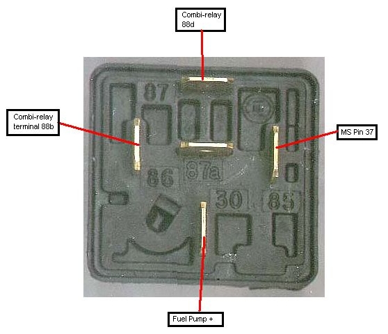

One more question about the fuel pump relay wiring...if you remember this is the pic I came referenced earlier in this thread:
download/file.php?id=4132
The question is about the connections to the new relay from 88d and 88b on the combi-relay. Did you leave the connections as is on the combi-relay and just add another wire from those connections to the new fuel pump relay or did you wire the relay inline with those wires so as to leave them still connected to those connections and whatever is on the other end of the wires?

Murray
Posts: 622
Post by Murray »
Kevin the connections for the relay have to be "in-line" with the existing connections in other words you cut the existing wires and run from them to the relay and then out to the fuel pump (Relay contact) and out to the MS fuel pump connection (relay coil).

In addition to my previous questions I'm looking at the fuel pump relay wiring again. Murray, is there a reason you said to have combi-relay 88b go to the opposite side of MS pin 37 on the relay (line in the picture I posted on thise thread) instead of just using the "always hot" 12v source from the starter junction box on the firewall?
