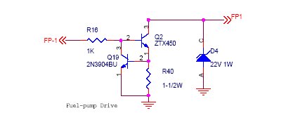

I'm in the final stages of understanding this fuel pump circuit and would appreciate some clarification.
In this circuit, transistor Q2 provides ground for the pump when the processor provides voltage through FP-1 and R16.What is the function of transistor Q19 ? The zenor diode D4 is there simply to protect against voltage spikes from the pump circuit ?
Once I can fully understand this circuit I'll feel better about modding it to provide +12V to the pump.
Thanks
Thanks
