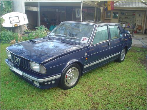

i just want to know if it would be possible if a alfa 90 bumber could fit onto a 85 giulietta ??
or if not what would ??

here in adelaide it is to had to find a alfa 75 bumper for cheap. if i where to put a 75 bumper it would be a 75evo.
at the moment i can choose for a stock 1.8 giulietta bumper alfa 33 , gtv or a alfa 90 bumper.
the alfa 90 bumpers dont look the best but i thought that the 2nd little spolier that comes down when u get faster looks quite kool.
also i heard that alfa 75 doors fit straight on a giulietta is this true ?

75 doors actually fit the Giulietta, the basic shape is the same. there are however some differences. the 75 has the plastic strip underneath the window, the Giulietta doesn't have this. the door is a bit different there.
Also on the 75 front door the mirror is placed in the foremost triangle of the window while the Giuliettas mirror is mounted on the door ( under the window).
The innerplate of the door differs also, mainly the mounting holes for the doorpull and doorcards.
75 has the lock in the door while some of the Giuliettas have them in the openingmechanism.
You can exchange them but it won't look good without work. :wink:
I've seen on the net a Giulietta with 164 bumpers.
We will fit 75 Evo bumpers on a friends Giulietta.
