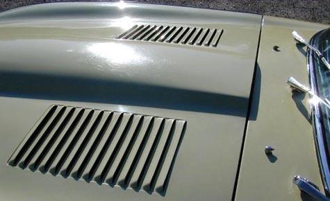

hmmm i wonder what a double row punched louved chunk of sheetmetal bolted in where the stock plastic on the hood would do for bay temps
Hey Short...that's a great idea...i've been looking for a scoop doggy, when all I need is louvers!!! :idea: :idea:
kinda like the old jag vents....but in the middle
borrowed from(actually a real nice car):<br /><br />http://www.californiaclassix.com/archive/61_XK-E_c17.html

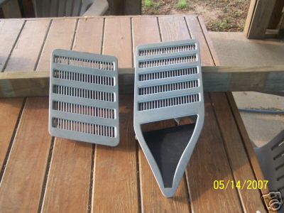

The 280ZX turbo has two hood vents that fit the GTV6 hood really well. One is a combination NACA style scoop and vent, and the other is just a vent.

unfortunately, 280zx vents are angled....

I am not sure what you mean by angled. The 280ZX Turbos scoups have curvature in them that nearly exactly matches the curvature of the GTV6 hood. I have a pair in my garage and I have checked this out pretty carefully.

MD: vents have an angle if looking down from the top....

280 vents
280 vents

HUWARF!!! .......thats just nasty lookin...looks like a lund POS non functional unit thats held on by double sided stick tape
not sure how well the curved lines will work on a gtv6 body with the body being so tight/square edged
