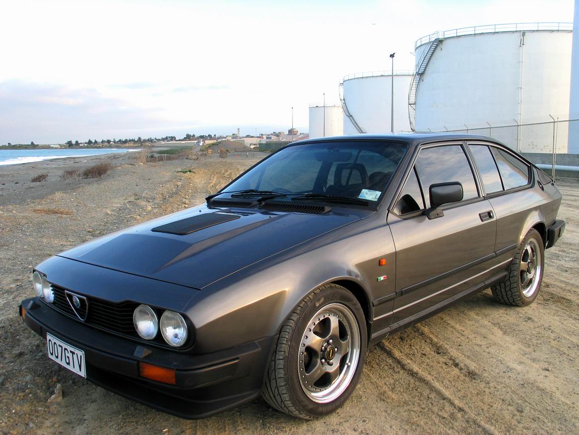

Finished putting the windows back in last night and most of the interior today after work. I'm pretty happy with the result. Good to know that the rust is remedied. Turned out to be a lot more of it than we bargined for. Still a few minor niggles to sort but over all its great to be driving it again after 6 months. :D

That looks great, got any more pics? What is the colour? charcoal or metallic grey?

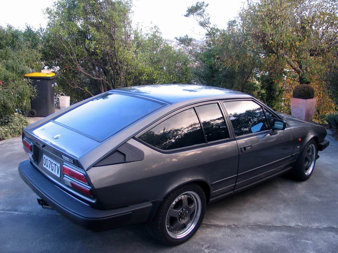

Hey tim, great car but is it true that the yellow recycler is actually turbo charged ?? :D

looks great tim.
Where did you get it painted?

MD, the red recycle bin, obscured from view in shot, is where we brew the nitro-methane super dog poo, top fuel that powers the Yellow "Super Bin". Legend in the street. Nic, the colour is a period Alfa spec but the chart from which I pick had no name just a 7 or 8 digit code.
