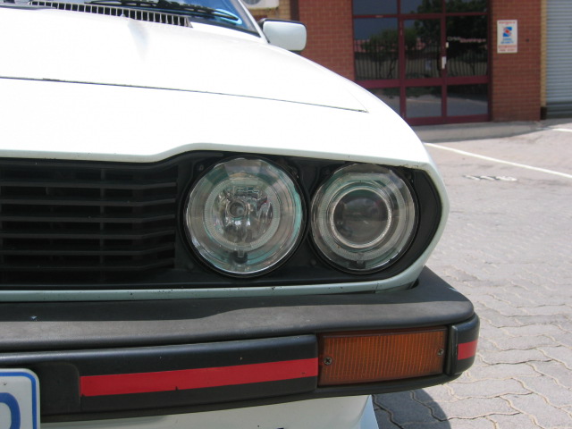

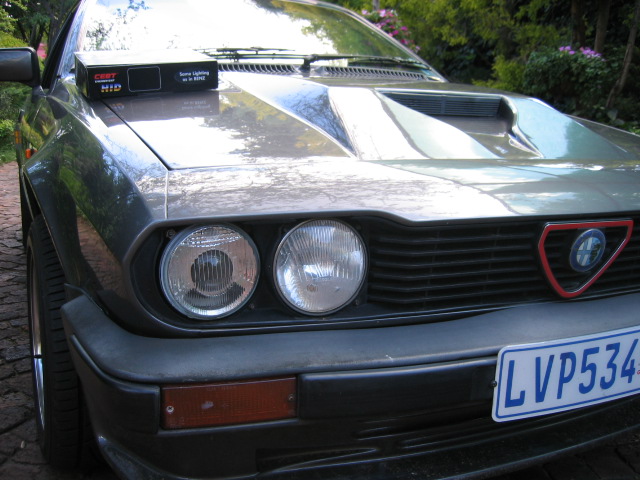

After trying various headlight modifications, including 100w globes with relays(spraying dangerously bright light), recroming the inners etc I have been inspierd by a mate of mine Peter, with his Xenon set up. I have just completed mine and with only 35w globes the visibility is remarkably different. The basis of these lights comes from the BM's.
I guess this thread should have been under electrical , all apologies.
This however does influence the exterior looks of the car.
The nice part about this particular conversion is that the convex lenses are still kept. Here is another Xenon conversion using the entire BM light with the flat lens. This is probably the easiest way to do it.

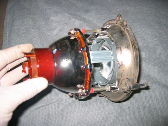

Here are a few pics of making the light (the hard way will post pics of the easy way)
another pic of the old way. Once the light is completed a tube is slid over it to seal it from moisture.

I have seen some after market HID kits which allow you to use a H1 globe and hence keep the existing headlamps without mods. I think they retail for about AUD$650. Not sure about intensity but I presume they'll be much better than OEM.
The h1 zenon kit is readily avaliable to put straight in with the existing lights(plus relay and fuse) which will definately be an improvement if your existing lights still have good lenses. What I liked about the BMW conversion was the 'projector lense" which gives you a far more 'intense' light.

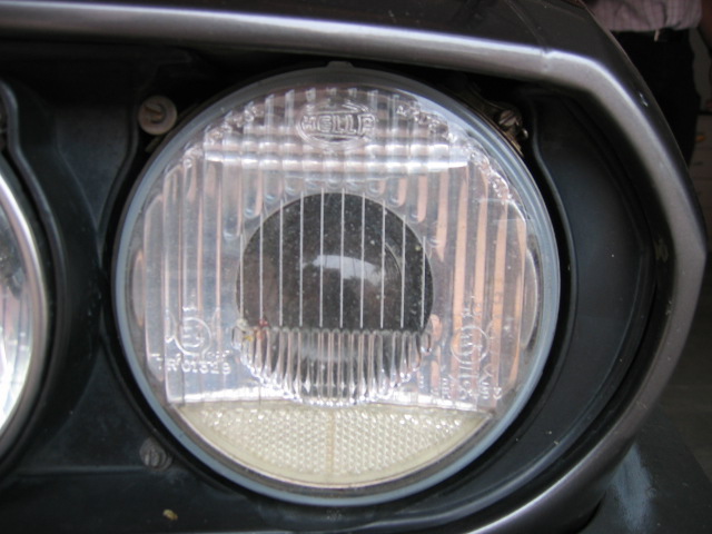

The easy way, finally. Take this BMW light and cut its mounting clips off. take an old GTV lamp and remove the mounting clips. Some clips can be removed with a par of pliers if the spot weld is not to strong or drill out the tiny spot welds. The mark the correct position on the BM lamp and epoxy the Alfa clips on. You dont even need to go Xenon route as these lights are pretty dam good.
Heres some pics of the Bm lamp before the clips were cut off.
Finally in car with Alfa clips epoxied on.
