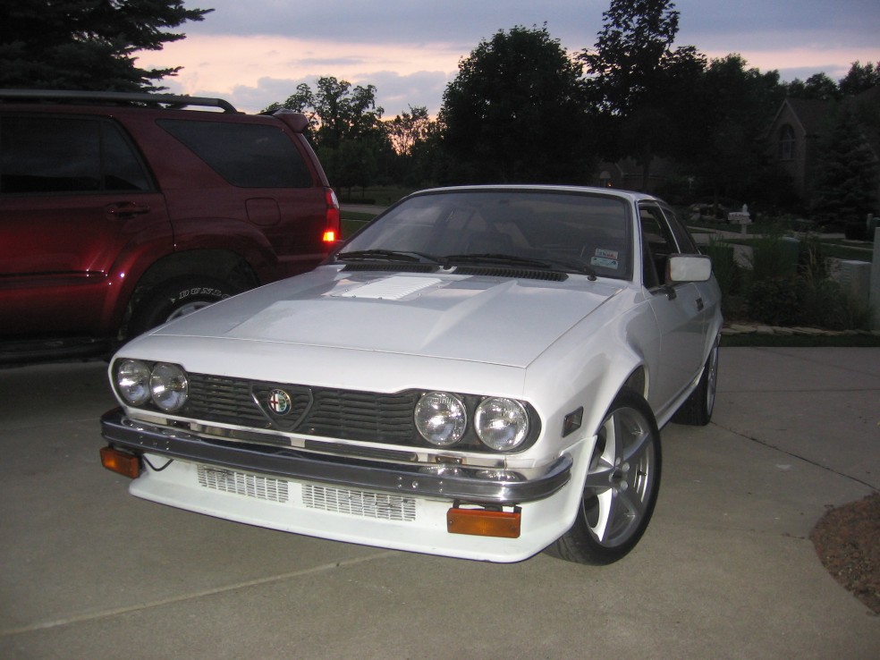

got the welder going...it took a few hours to fab the bumper supports..a good father son project as my dad was in town
bumper is a little lower than stock because I want to put in one of the chrome Alfetta center grills
turn signals are temporary
anyway, found a source for 3 x 3 woven stainless mesh and will replace the upper and lower front grills and headlight surround, and then replace the headlight mount w/others...eventually

maybe its just me and maybe its the angle..but the wheels look likethey clash with the bumpers..otherwise i like it

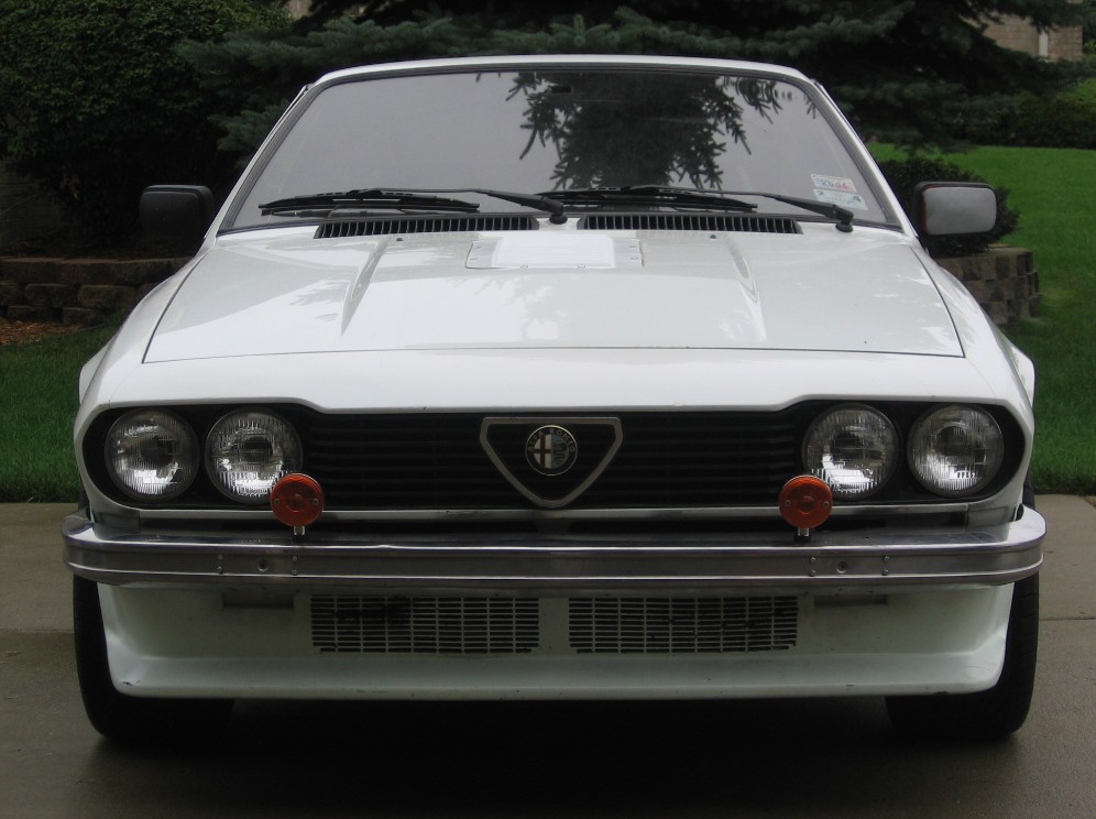

NEW TURN SIGNALS
I had the week off so many posts from me...in between changing diapers, that is
Anyway, finished mock-up of front bumper w/turn signals
see what you think..also put a vid up on youtube:
http://www.youtube.com/watch?v=eZNcyZCCSik

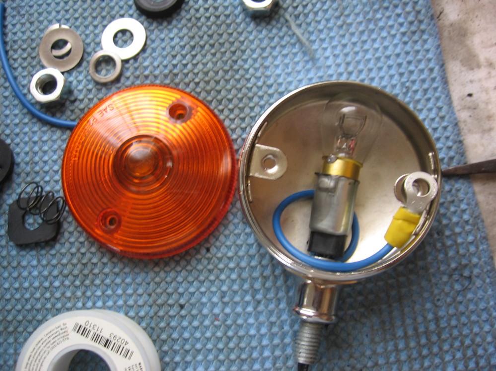

Had to convert single filament holder to dual, just a little grinding and soldering.....

MALDI: long story there...it took four months because I ordered another set which never came in...and finally I got these which worked out after a little work..
If you are interested..you need to get ECHLIN part # LS6114 (two filament tail light insert) and cut off the crown to get it to fit into light housing.
Put it into 3" Amber round 1-face chrome case marker light #30574 made by United Pacific. This light I bought at the "BIG RIG CHROME SHOP" on the net. Have to drill the mounting bolt down the center a little wider to accept two power leads(turn and running lights) and ground it internally to case ...like my photo above...Blue wire is ground from bulb insert housing to light case, which is then grounded to bumper by mounting bolt.
Total cost: 10$ for Amber light and 4$ for Echlin insert...pretty cool for total of 28$!
PS: uses standard dual filament bulbs..buy the heavy duty filament ones and change them less often
Remeber: you saw it here first :)
