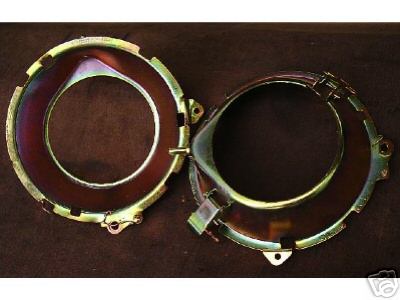

After breaking one or two trying to adjust the headlight aim, I realized that finding these little buggers is as difficult as making new ones. I tried to use brass inserts(the ones used for woodworking) placed into the grill. This worked well, but adjustability is limited. So, I considered a whole new headlight mount which uses 5 3/4 inch rounds. Found that the BMW 325 late eighties headlight assembly pictured below is very close in size to the Alfa light positions and has mounting brackets. New price is a little high, but considering that Hella conversion is almost 100$ a pair, it's not much more for new BMW parts (or I could look in a junk yard). I plan to trim out the back of the grill where the lights go while leaving the front portion of the surround intact. Also, a mounting frame will be fabricated behind the grill to mount the BMW 'light rack."

These are real nice, but i am still faced with the problem of rusted out screw mounts stuck in the grill. I remeasured from some good photos..The gap between the headlights on the BMW mount is a little too wide for the alfa, so this would need modification as well. Did see some sheap ones on ebay, though.......

I just scored a set of 1986 BMW E30(very common) chassis headlights on ebay for 30$. These are definate NOT the elipsoid superbright specialty lamps! However, these are the all metal housing type (as opposed to the aftermarket and newer plastic types) which makes my job of modifying, cutting, welding a small frame much easier! There are two posterior adjusting screws for each lamp (look like the nylon retainers for GTV6 tailights). I will probably make a small access hole just inside of the hood mounts and fab some kind of plastic cover for them.
These are standard sealed beam headlamps which cost about 8$ on the net. I could still install the H4 bulb and lamp housing if I wanted to spend an extra 200$

The plan is to use the old e30 housing with new cheap Sylvania lamps. Later, I may want to use newer (and cheaper by BMW standards) aftermarket 5 3/4 inch housings with H4 bulbs. I don't plan to use the BMW lamps specifically as they cost too much. They would look nice but I don't think they will fit.
