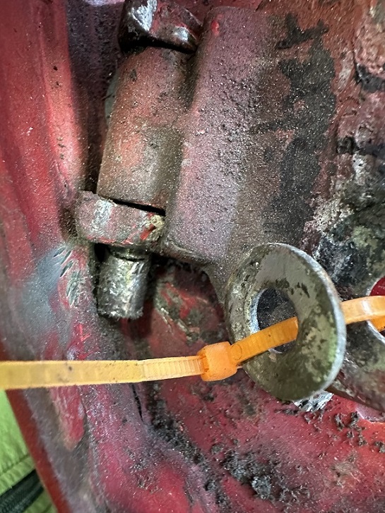

I got the hinge pin on the bottom of the door out, just using a drift and a hammer. This is obviously the easy one.
Seems to be 8mm in diameter and about 46mm in length.
Its not held in by anything except friction (the top and bottom are not squashed to prevent the pin from moving out of the hinge)

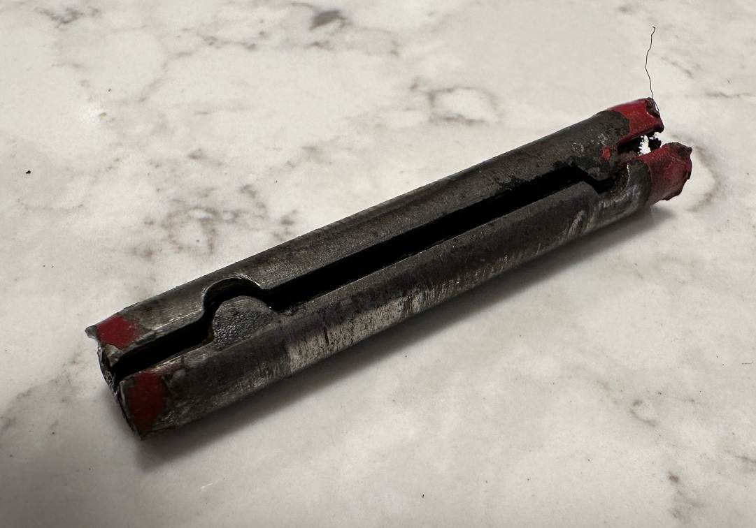

The hinge pin is called a Roll Pin
Obviously the pin will only come out by some form of impact. Getting a direct square on the bottom for a PUSH impact is problematic. Therefore I am thinking some form of PULL arrangement is called for.
To do this will require a clean joint and a careful weld of a Slide Hammer tip onto the top of the pin.
After a good soaking rest with some anti seize application to the hinge, a careful combination of the impact from the slide hammer AND the occasional strike on the bottom of the pin from a conventional drift and hammer should get the blighter moving.
Doing it a small bit at-a-time with lubricant application in between should see the pin come out.

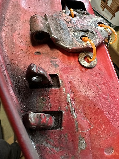

But I have been able to remove both pins!
I used this dremel cut-off tool and was able to use a drift to knock the pin slightly out (about 8mm at a time) and then the dremel to cut off a section of the pin, Cut, tap, repeat.

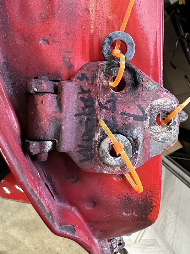

Side note.. these photos show that my car is definitely well used, this has never been a weekend car. It’s not quite so grimy irl 😝
