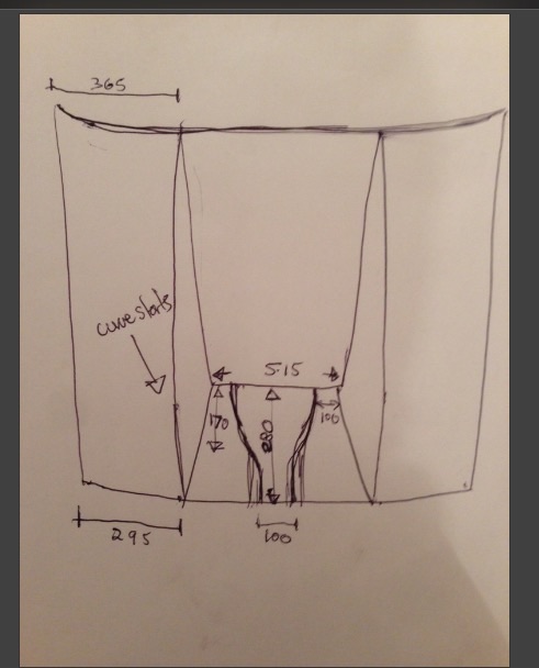

I'm looking to replicate aspects of the NACA vent in carbon fibre for my bonnet and was hoping someone could measure the major details on their vent for me?
Let's say: width, height and placement (how far up the hump?)

I will sketch something for you Jules

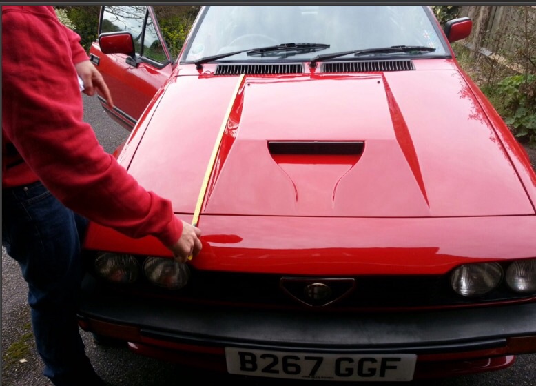

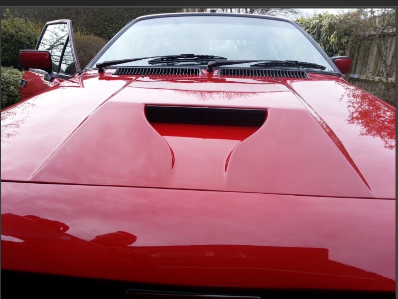

Hi Jules
This is a really rough sketch . I have taken some pics as well to highlight the line of the bulge is not dead straight but curves slighly .( this line is shown in pic with tape measure running alongside it ie from windscreen to nose) Also the height of the bulge relative to the sides of the bonnet is 55mm while in the duct area it is 40mm taken along the same cross section ie on a ridge line running from left wheel to right wheel . Ask questions and I can fill in for you from these dims
