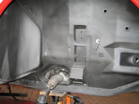

I removed, from the front wheel arches, all the underseal and Schutz. Cleaned all the rust and recoated in Zinc primer then stone chip(picture attached of current state). Next job for the front is to Schutz then top coat (red). My current job is getting the middle and back of the car to the same position.

- Near side front wheel arch stone chipped.jpg (20.68 KiB) Viewed 13357 times
nice job
, how the heck did you get all of the underseal and shutz off though? its a bitch to get off! I have been thinking of doing the same thing with my dedion, but cant bear to have the car off of the road for that long, so just a good clean up and hammerite smooth instead.

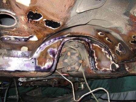

How did I get the old Shutz off, heat gun and an old chisel. Took almost 1 day per wheel arch. Contemplating doing the same for the underside. Below is the current state of the underside. Thankfully all the rust I found was superficial, except one small piece which I will have to weld up. All the rust has been removed and coated with Dinitrol Rust Converter RC900.
- 250707 003.jpg (34.15 KiB) Viewed 13272 times
Hi, its looking good. I agree with you too, my mechanic friend is wrong about the bare metal(mainly) I too found the same thing today (just finfished for the day 10 minutes ago) whilst under the car, mine has a black primer on to bare metal, but not on all the panels strangely, I found the very lower inner wings had no metal primer at all!
I will have to try the heat gun, the chisel on its own is giving me a blister
