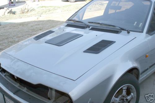

This v6 on ebay had an approach ... though I can't say that I care for it ... look like 280ZX vents or something??
GV

They look a little tacky, not to mention they are back too far. Vents need to be as far forward as possible, and scoops as close to the windshield.

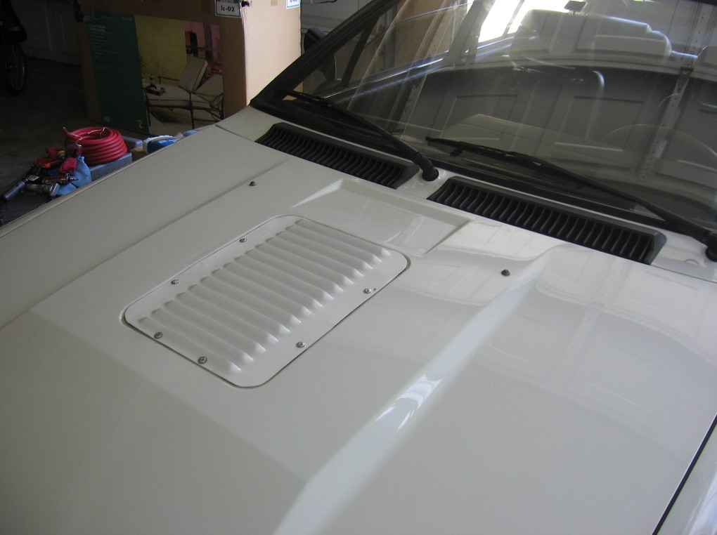

Well here it is, painted white for now to match car....
By the way, this vent works...a lot of heat escapes when driving...vent is hot to the touch after a cruise...and radiator temp is down
I think this is a good use of the hood hole if like the look...

xrad - Been out to lunch for a lot of the summer (and have my interior out) - like the vented hood, but it would be nice if it had a more finished look ... yeah, I know easier said then done. :)
The darn plastic panel in the hood thing I've quit thinking about just because I can't figure out anything better - on one hand if it was just smooth it would be better, but I tried that and am not so sure. And don't care for the look of a Callaway scoop. The S.A. 3.0 hood is the right thing but good luck on that one - though I suppose you could buy a hood, seal up the hole and cut the vent, etc. like one ...

It will be welded in and gaps smoothed when body work done...rivets are temporay
I think it looks great the way it is, but smoothed in will probably be even better.
