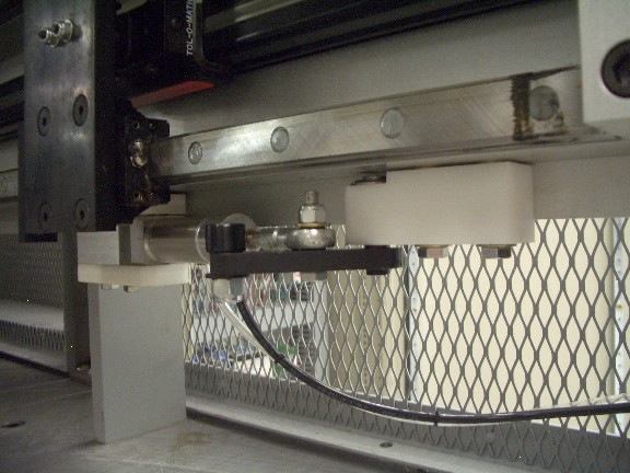

Delrin can be easier to machine than Nylon or UHMW or similar.
Delrin and stainless makes for an excellent dry bearing/bushing.
Check out the attached pic. The white parts are Delrin. We use it for bushing blocks all the time here.
