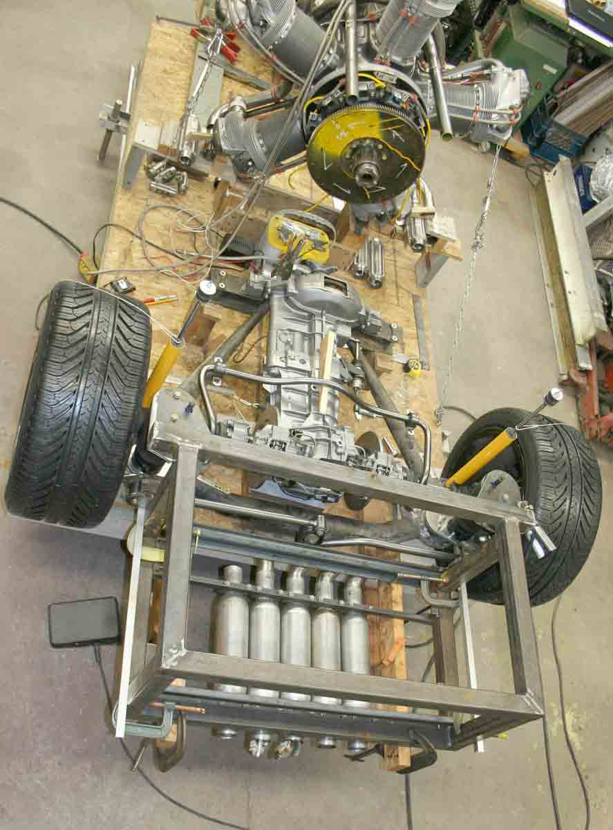

Re: 86 GTV-6 REAR SUSPENSION SETUP
Here's the latest photo of the 'Alfa end' of the project (LOL)
- FuelCellFab-2wr-2.jpg (59.67 KiB) Viewed 11834 times
