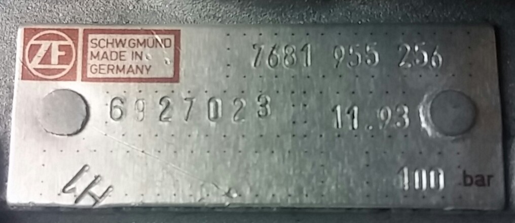

164 pumps work at 100bar, rack needs more, 75pump works at 130bar, so i had to replace the pump

I've finished pump conversion today. PS pump works really nice, no overheating or strange sounds, tried sharp manuvering left- right-left and no problems with oil starvation. Oil in expansion tank is still and without bubbles. Next test will be on track in september (hopefully).
Pressure control valve and orifice. I've decided to modify this pump because orifice is not press fitted. It pops out easy.
Fabricated orifice for less flow (left), one hole 2mm diameter. Original orifice has three holes: 3mm, 1.5mm, 1.5mm.

Hi Killaz, just curious the holes in the restrictive do they go right through as in one hole either side or just one hole on one side of the brass piece?
killaz
Posts: 218
Location: Belgrade, Serbia
Re: steeringpump faillure
Post by killaz »
Hi! I'm not sure if I understand you, but I'll try to explain: In original restriction for this pump; there are three holes on sides that are connected with main hole which leads to supply line. On new restriction, I made only one smaller diameter hole if compared with factory unit. It would be cool to check and compare parasitic losses with this setup? :)
I was driving track day with new setup and no problems (sunny day 25 degree C), lots of charging 5000 rpm-7200 rpm. Works perfect but for hot days I'll mount aditional cooling tank to keep oil in better temp range.
